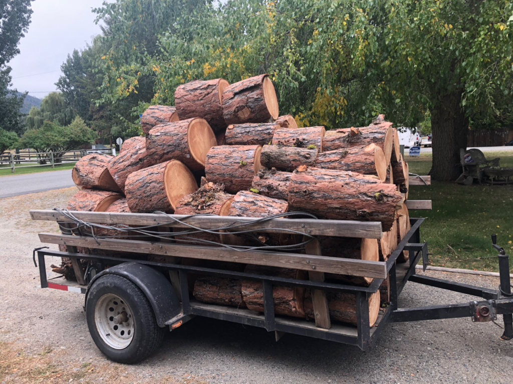

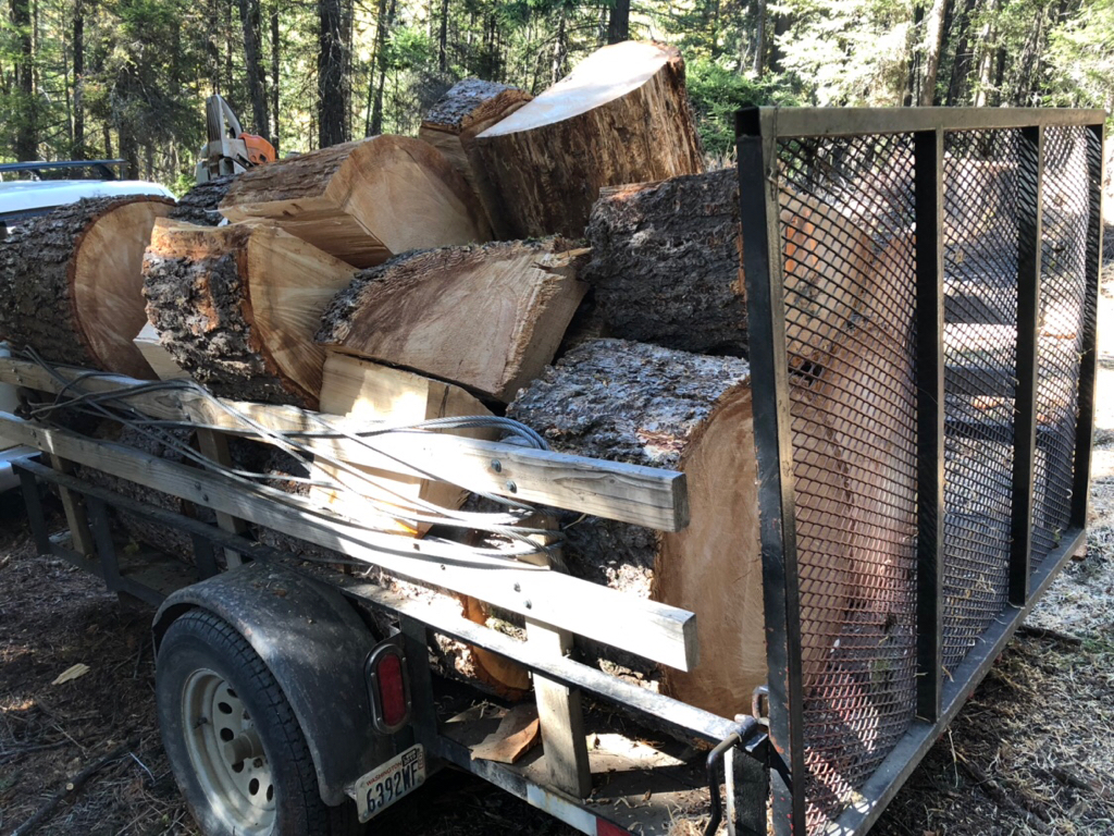

I’m a little late to reply, but I use a 6x10 with a 3500# axle. If I pile it high, I can get close to two cords at a time on it
I find it to be just the right size. It’s small enough that I can maneuver it into some pretty tights spots, but big enough that I can haul a prettt good load.

Correct, 3500# is the “rated” capacity of the axle. The trailer itself is about 900 so that leaves me with 2600# working capacity.
I only cut wood a few miles from my house. It’s usually downhill on the way home. I also live just about in the middle of nowhere so it’s highly unlikely I’ll see a State Trooper on the way home, so I may overload it a bit...lol
The capacity is usually stated by the manufacturer of the trailer, or axle itself if that’s all you’re buying. If you’re working with an unknown axle, you would need to measure the axle tube, bearings, hubs and compare those measurements to a known axle. Also make sure the tires are up to the task.
