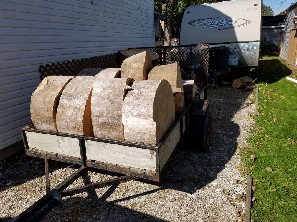

Heres a big ash i started cutting up this am. Thats a 25 inch bar in the 038. Must been close to 28 to 30 inch on the stump

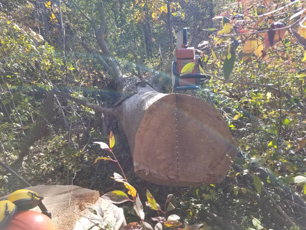

Couple back leaning cherries with a little rot, fun stuff.
Screen Shot 2019-10-19 at 10.37.18 PM.png Screen Shot 2019-10-19 at 10.43.55 PM.png Screen Shot 2019-10-19 at 10.44.48 PM.png
The second one was cut above the knot my saws in 1st picture, you can see how high it is here.

First one wasn't leaning to bad to drop, but its different working by yourself than with others, some benefits to it though also.
This is the hard leaner and the one that was cut at about 12'.
Had to change my pull angle a bit on this one.
Oh I didn't read the first post so here's the saw used to drop them.
