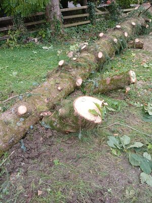

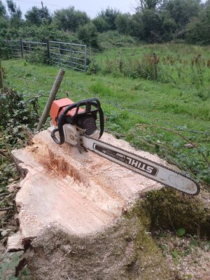

Some conifers from today.
No wind today, made for a nice change.
Stripped this spruce of its branches, took the top out and 1 section of the trunk then felled the rest.
Look how it pushed the logs we laid out into the ground. Very soft ground, I think it had been resurfaced and never packed in.

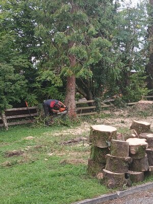

Nice straight lawson cypress. They usually develop multiple stems.
They're notorious for developing rot down near the butt.
Someone mentioned ivy, heres some ivy for you. There's 2 Scotts pine trees in there somewhere. Luckily all we had to was fell them, God help the poor man that has to cut them up.

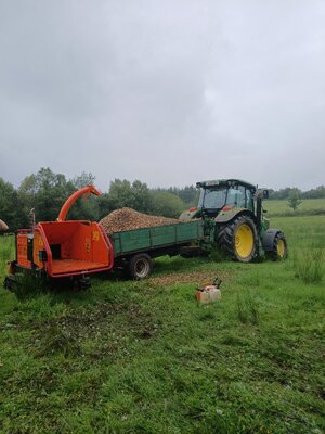

Back to storm damage today.
Cut up a few fallen bog birche trees.
The land owner brought his trailer to fill with chip. He's going to use it to bed cattle.

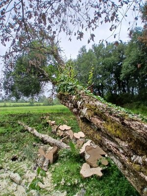

This was the biggest.
Fair bit of weight to it for it to not start lifting up when we cut most of the limbs off.
Peeled all the way down the root flare and into the ground.
It was weird watching a tree lying horizontal swing over to one side.

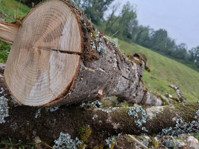

The only standing tree of the job.
Another big dead ash.
Note how the next tree to the right looks a bit better and the next one again looks pretty good
It fell nicely for such an ignorant dead tree.
A stem had tore out of it few years back. The wound was where I had to put my face cut.
The tree split into its three remaining stems from the impact of hitting the ground.
Shows you can't always trust those unions to hold together.
