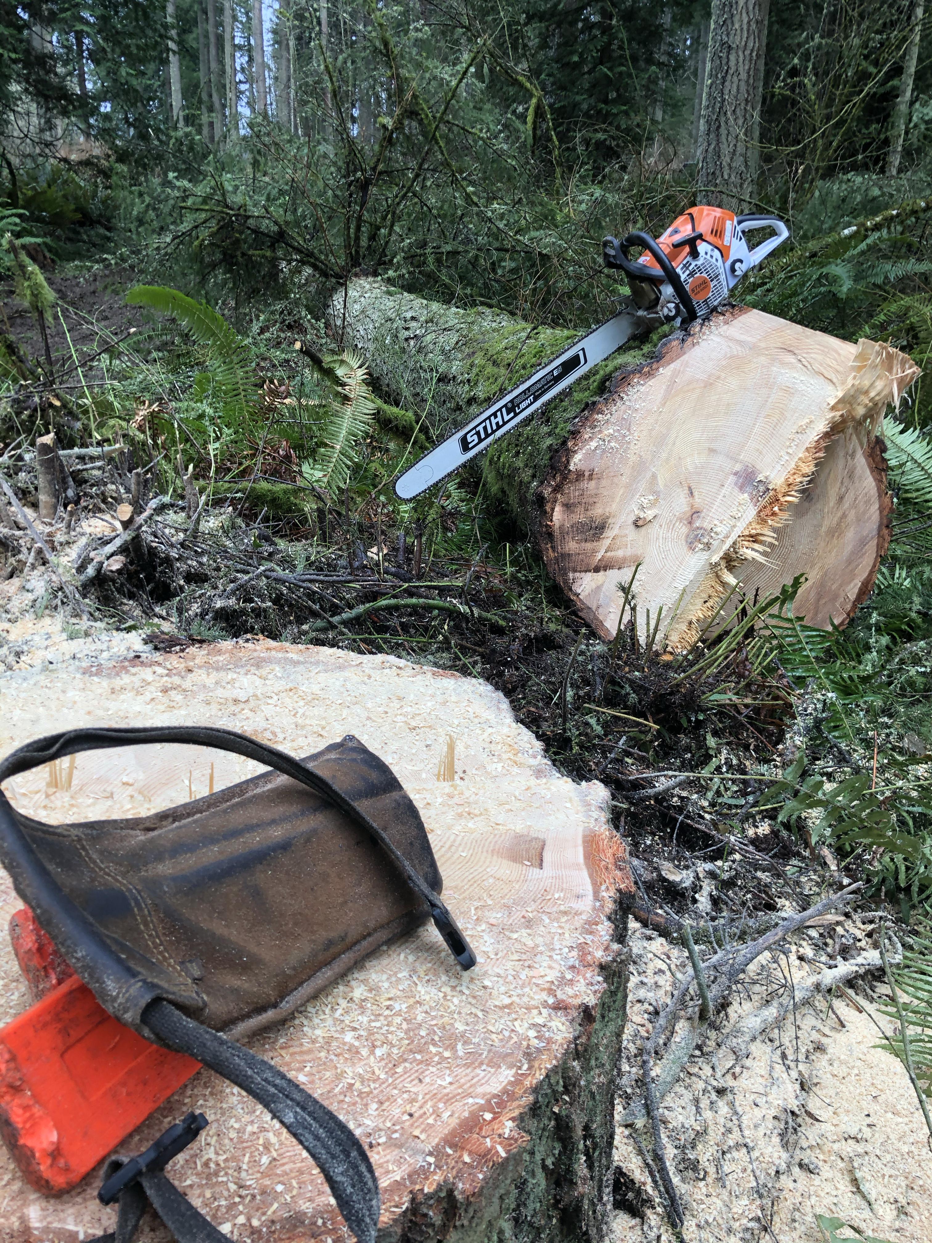

Last one of the day and an ugly sob at that.
