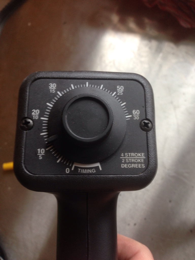

Correct. Unlike the currently used "wasted" spark type simplified ignitions on most small engines these days, a dizzy is still driven 1:1 by the cam which is driven 1:2 by the crank. (1 being the cam, 2 being the crank)
But in talking about timing lights, it escapes me as to why it matters whether it is checking ignition timing on a 2-stroke or 4-stroke. Ignition is still occurring at X-degrees BTDC. It shouldn't care whether it's happening on the exhaust or compression stroke, or whether it is reading a 2 or 4-stroke... My timing light just hooks on a plug wire, then to the battery, and flashes each time the plug fires.. It doesn't matter if it's picking up a wasted spark on the exhaust stroke, the timing is still what it is. It doesn't change.
This only applies to timing lights that have an advance feature. The straight up timing light is just going to flash when the ignition sparks.
The timing lights with an advance feature have to calculate the time in between actual ignition pulses to spark. So therefore it needs to know how often in revolutions the ignition sparks. On the 4 stroke setting is expects every 720 deg on 2 stroke it expects 360 deg. If it doesn't have a setting then it's going to be on 720 deg, then to do a two stroke or wasted spark ignition you have to divide the number on the dial by two.
Here is my timing light, note the two sets of numbers on the dial.

Thanks for the explanation.. I don't mean to sound ignorant, but I didn't know there are timing lights with those features and capabilities. Interesting. :)
So what does it do?? Calculate your all-in advance on an engine equipped with advance like a SBC without having to run the engine at the RPM required for full timing advance???
Thanks for the picture Shawn ! I've got 3 lights, all with advance, only one has a 2 stroke/ 4 stroke switch. I guess the other 2 I'd have to divide by two.
No, it advances the light flash so you can set timing at full advance with ought having timing marks for 30+ deg. Set the dial and it flashes that amount before the actual ignition spark.
