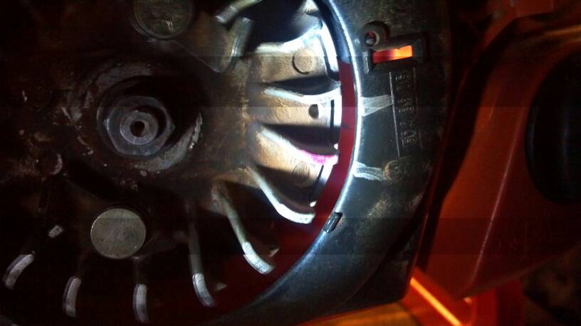

here is where my 350 runs. Its 21° iirc.

How does one determine where 0* is on the coil firing?
What are you using as a reference point?
Is it when the magnets are in line with the coil legs?
I'm just trying to wrap my head around it as well. I've been advancing timing on every stihl I build.
On an MS260, I went from 20 to 30 off the keyway and the saw gained 500-1000 rpm with no other changes to the saw. The saw was fully ported though.
I simply used a timing light , marked a fin on flywheel, mark tdc as shown in my pic above, started the saw (warm), and removed the recoil cover. Trigger the light and mark where it flashes.
Just hook the light to a battery and to the plug lead.

A timing light with advance can help alot, more like a boatload.
Just dial in the advance as you are running untill you match up the TDC mark, then read the light for total advance[
How are you guys starting a saw and flashing the flywheel?
