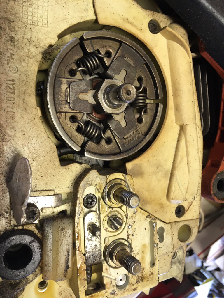

Good to know I guess, I have an ms 210 easy start at the house but I need the other coil because all the ones I have won’t fit. I’m pretty confident the saw only has a few tanks through it. Back handle was smashed and the saw looked new besides handle. I think cost to buy handle plus repair was enough for the guy to just buy a new saw. So became parts saw and someone needed a coil.

029:
No chain brake. No sign it ever has one.
WTF!
Oops! Yes it did.
I’m not going back with one. Not up to chasing down parts. [emoji57]

Now let me tell, more often something happens to the brake and they just take it off never to be seen again .It took me about 10-12 years to find one for an 042 Stihl .Fred ,AKA "Stihl boy " showed up at a GTG with a pick up full of parts including the bones of an 042 .I took a picture of the assembly before I removed it from the donor .I've traveled that road trying to figure them out from a pile of parts .It often takes a few tries and some foul language .
