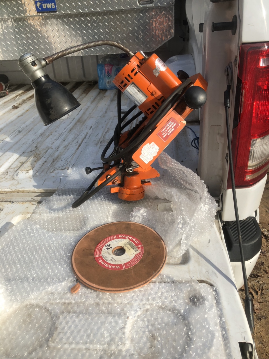

Mark any additional info on “Combination Oregon 511A & double Silvey chain saw sharpening stand” ? I saw some discussion about this on Facebook today but no real details.
GCJenks204
"Special Buns"
7:45 AM
367
15,776
100,596
Winnipeg, MB
I will see Pat again next week, I will try to get some better photos.
Shipping to Canada could be very interesting...
Mark
Would have to be one of those "buy enough to make the trip down to pick up worth while"...
I wouldn't even know where to start with something like that but it is pretty cool.
That Diagnostic kit should be of interest to a few different people.

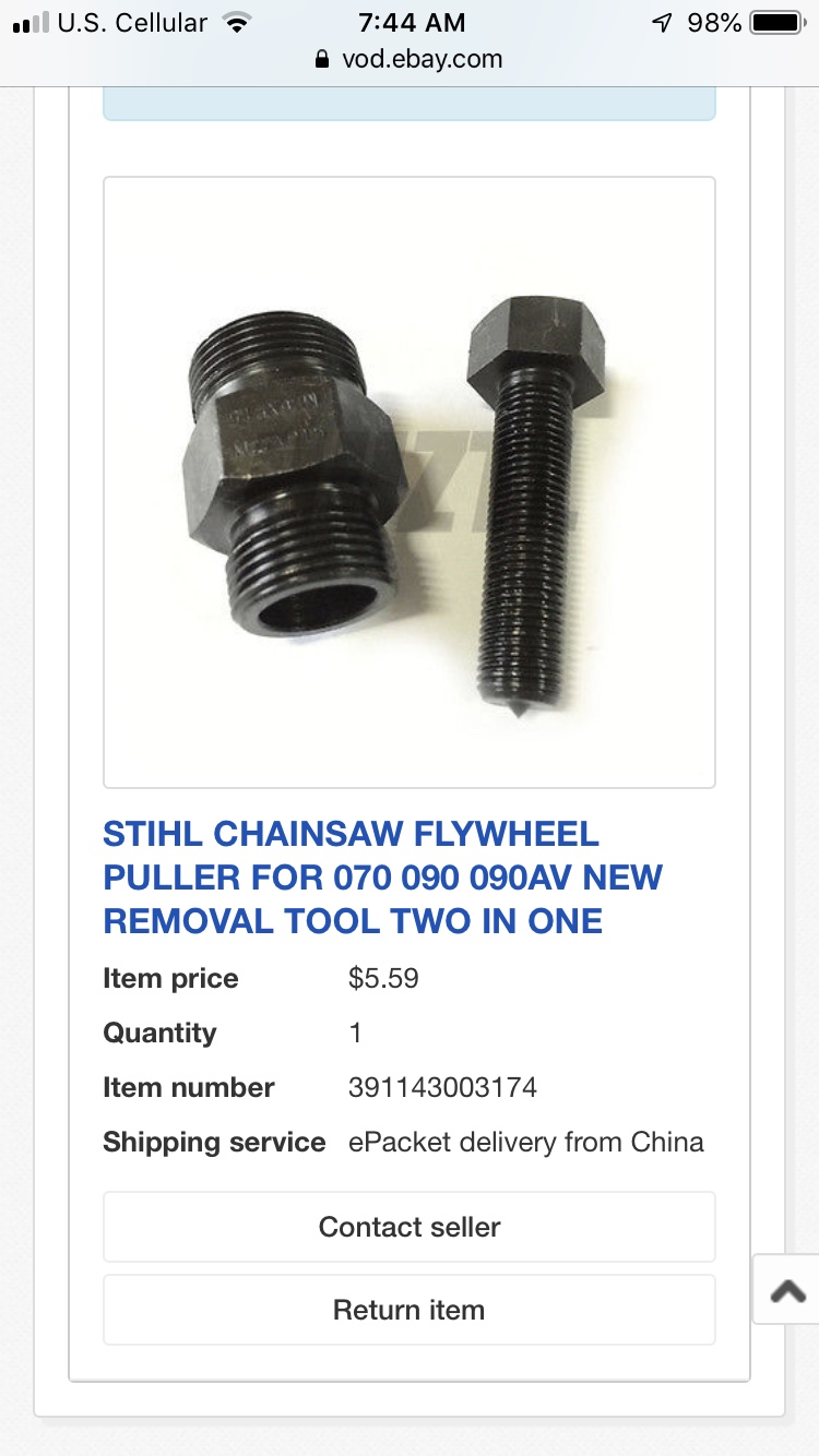

$5.59 shipped to my door. How can they even buy the raw materials much less get it to my house for that price.
The thing about free shipping, is that it takes forever. I ordered the damn part on nov 22 and the estimated shipping date is dec 1-dec27. I guess my shipment delivery date is based on the trade winds.
