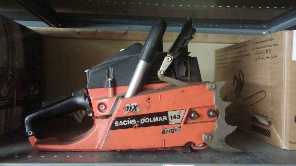

Stroke is 40mm on both 133 and this. Do you know if the 143 will bolt to 133 chassis?

looks like the 143 crank is a different part for some reason. I think someone said there was a heavier bearing or something on the 143 and 133super.

Edit: the later 143 and 143mx had what dolmar called "contact ignitions" and so there was a change in the snout of the crank for those saws vs the 123/309/133/133S. As for the bearings... Dolmar used to use a roller type bearing from what I gather. It seems they were using these roller bearings on both sides of the crank. However, there is an IPL reference to the ability to replace the FW/Ign side bearing with a 6203-C4 ball bearing. The bearings are also cross referenced with each other making me believe that a set of 6203-C4 bearings can be used to replace both sides. The same IPL cross references all 4 versions of this saw. Thus making be believe that both bearings on the 123/133/133S/143/143Mx/309/343 can be replaced by 6203-C4.
I do not have first hand knowledge of this myself but am making inferences from the IPLs and other references that I have found.
Different bottom ends aside, iirc, I was told you could bolt a 133/143 jug onto a 123.
Now will it hold up? Not as long I'm sure.
I could be mistaken though.

go back and read my edit: The cranks are different due to the crank snout and ign changes. I think the crank and bearings are the same throughout strength wise. Dolmar would have no reason to change tooling to change the crank between all of this series saws; it would just cost them more to make each saw and more parts to keep on hand. I could be wrong, but I don't think you'll have a problem bolting a 143 top end down (if you can find one).
