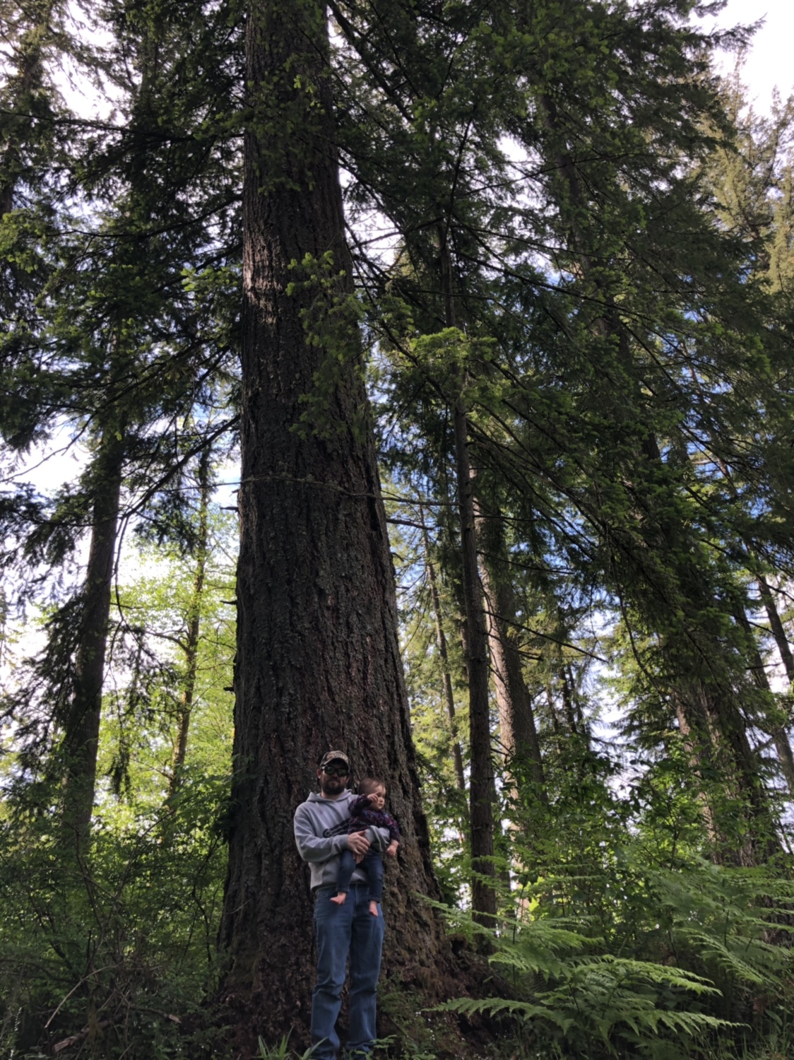

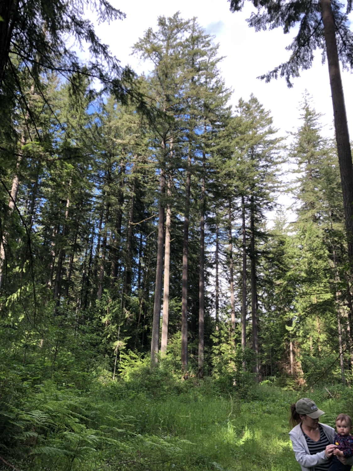

Out dinking around on the farm this afternoon found a few big old girls that need to come down in the near future.
