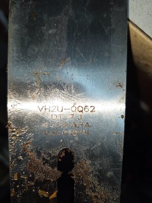

Can anyone tell me if this is the right bar for small mount Husky. It fits, but it's real tight. Thanks.

Yeah, I guess all vh2 bars are k095. Ain't got much room to put the chain on...
Yeh, for whatever reason there are some saw/bar combos that need a chain one link longer than what is called for.
One of mine is that way. Once it stretches, it's fine. pita to get on the first time though.
