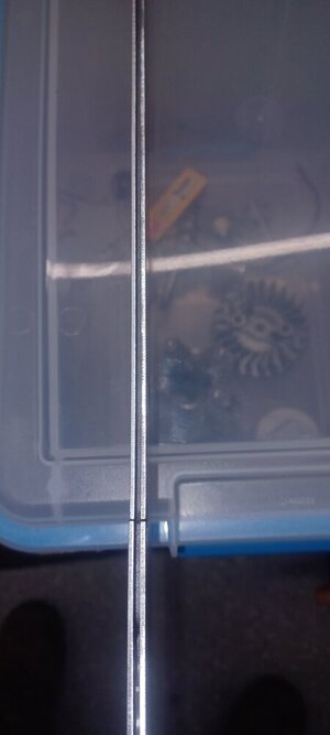

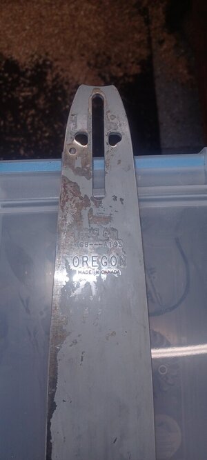

I have what is supposed to be a sm mount Husky, 16", .325 bar.
It came in with a .064 groove that I dressed down to .060-.061. So, I'm guessing a .058g.
A worn .063 chain would "fit"
The mount matches other sm mounts I have except for the adjustment hole.

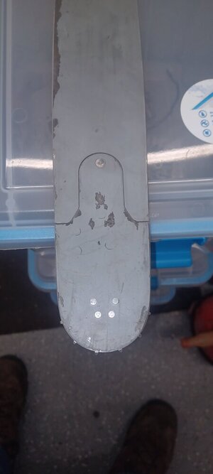

The tip is the size of a regular, LG mount bar rather than any other sm mounts I have.
Any ideas?
8747 GJN
168---A195
.325 tip
