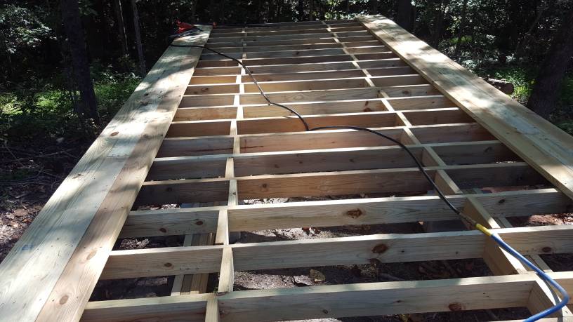

Did you glue and screw those triple 2x6s?

OK. TY sir.
Tough to glue pressure treated wood like that.

That looks pretty stout.
That is almost 5000 lbs of tractors...

If only I had a steel plate, I could frame a floor in. At this time, my entire sugar shack budget is $0.00. If I buy a couple PT 6x6 or round posts, it's not the end of the world.
I understand. This project was on hold for 5 months sorting price VS strength. I stumbled into 74 16' 2x6 treated and 15 4x4x8' treated for free. All new.
Floor system, ramp, and block piers less than $200 out of pocket into it. I got very lucky.

What did you use for flooring? 2x6s?
Looks nice and strong.
Yep. When you have tons of 2x6.. you use 2x6. The design works for me. Robust and water resistant. If I bring a wet machine in I do not have to worry about the floor moving.
