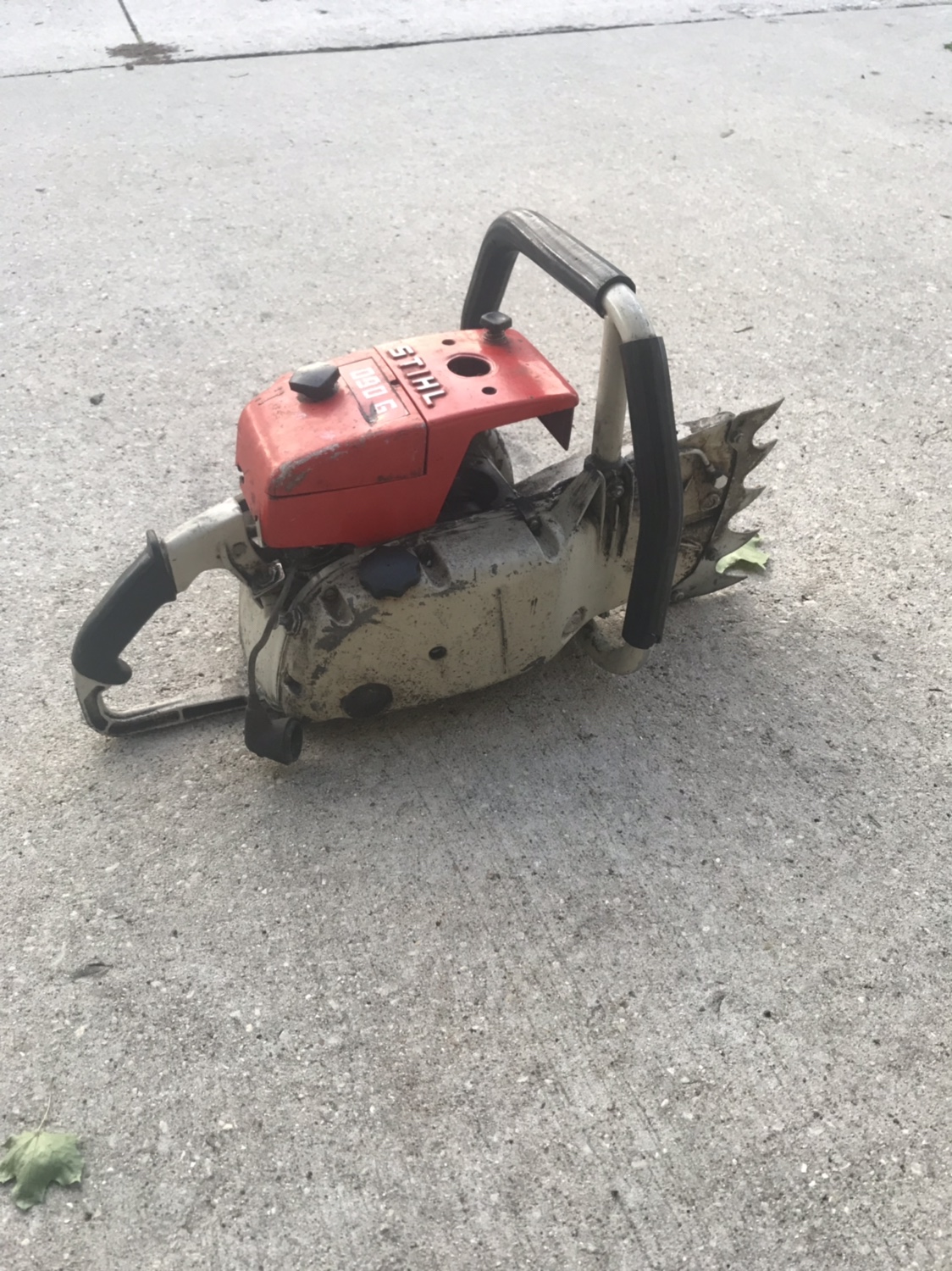

Roomer has it, it has a scored cylinder and damaged piston from something dancing around top side. Last I see the saw was probably 10 or 12 years ago. I have to go tomorrow and pick it up. Anything I should be looking for when I get er home?

A large box to hide it in.
I'm only sort of joking, they are well made, if you can foot the bill and be happy, more power to you.
I've run maybe 8 or 10 of them, of all ages and types, I always pictured them as water pump power plants.

That cylinder won’t work. It’s a g so 58mm bore.
Piston and cylinder has some scoring but it might clean up.

Like I said. It did come with 36” bar. No markings on the bar, just the Oregon roller nose. And the like new 1/2” pitch chipper chain.
Edit. It’s a special ice chain. Sort of looks like a scratcher chain of old.
I must has missed where you mentioned it's a Gear-drive, regardless the 66mm 090 top end is a bolt on upgrade.
