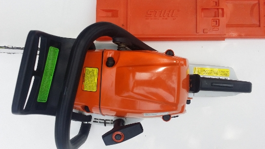

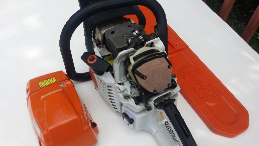

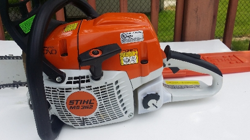

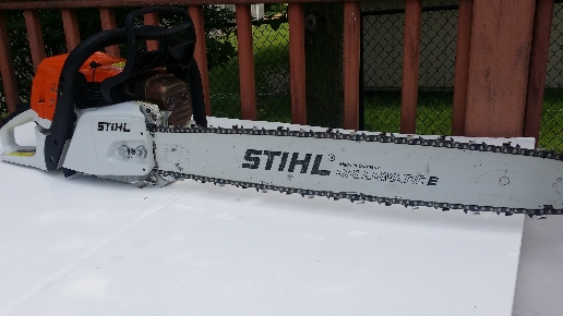

Found pics of the 362 I let go. It was basically brand new.
