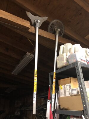

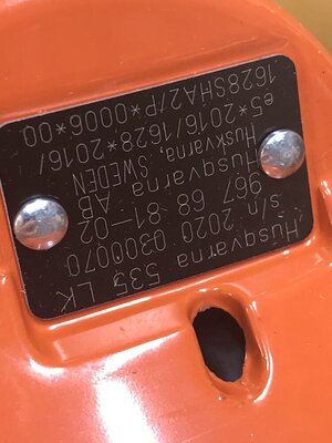

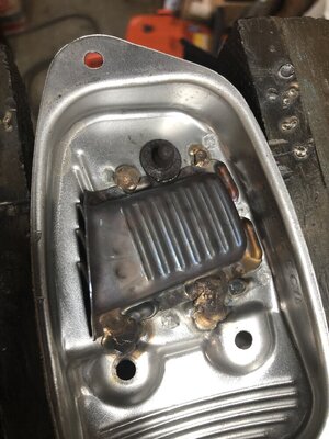

I’ve got the Husqvarna 535LK head with the articulating head hedge trimmer , weed whipper, pole saw (converted to run a 16” .375 lo pro chain), 3 brush cutter attachments with different blades on each one, and 4 additional extensions. I took the catalyst out of the muffler before I even put fuel in her. You could offer me 2 complete Stihl systems and I would still use this Husqvarna 535LK. I picked up everything from when the owners (Bruce) ran a 20% off sale …July 2020……. Killer deal !!!!!
I use it to clear weed overgrown woods, the blade cutters slice through 6” saplings (if 6” are still saplings) like a hot knife going through butter. Rarely ever need full throttle and sips fuel
I’m never getting rid of this !!!!
