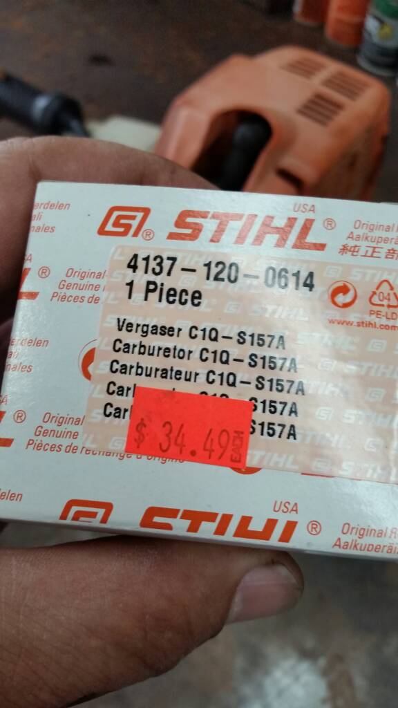

Does anyone know the correct Walbro carb for a FS-85? Rather not go with a Zama.
Carb on it is a non adjustable carb and it needs to go.

got this yesterday, it is fully adjustable. Didn't look which it was but my fs 80 runs good now
