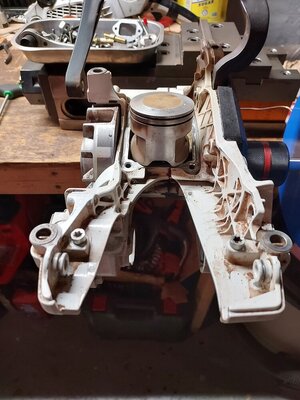

Built this for a buddy last year... still going strong. Thought I had more pictures.
Look at that intake timing!

Are you cutting the band and crown at an angle?
Yes. And on some saws I match the roof of the exhaust with that angle... and on RARE occasions when I can, I match the angle of the piston to the floor at BDC... kinda like how some of the older saws were, homelite super 10, XL, etc
