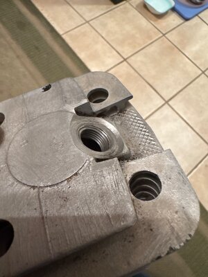

I use the Helicoil brand spark plug thread repair kit, with the edition of a bit of Hi-temp thread locker. The trick is to get the proper length coil in place so the ends are well within the new threads, this is what keeps them from backing out. What's nice about this version is it can be done on the saw with some grease applied to the cutting/threading tool to capture the chips.
The absolute best repair is to take it off and get @srcarr52 to weld and rethread it for you. He does excellent work and I highly recommend.

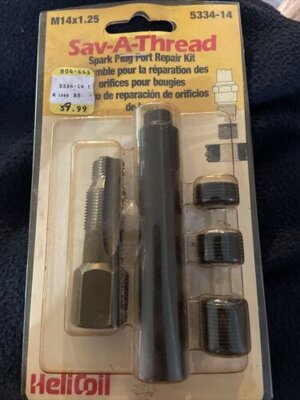

This is the Helicoil kit with solid inserts. The swaging tool locks them in place when done properly. Available at most auto parts stores.

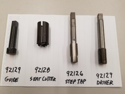

Timesert also makes spark plug inserts of different types. including washer seat and taper seat designs. They require a special tap, seat cutter, and insert tool in addition to the inserts themselves.

Looks like Helicoil brand makes every size except M14 X 1.25 from what I can find. Lots of other brands
