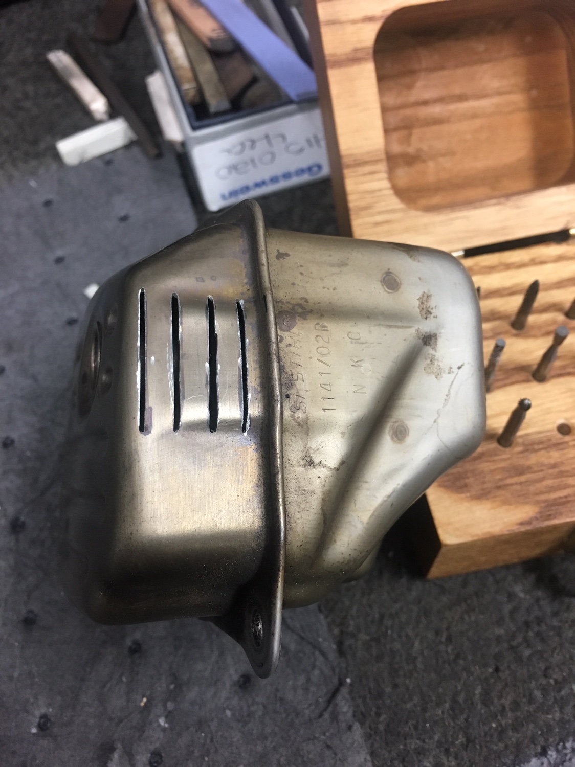

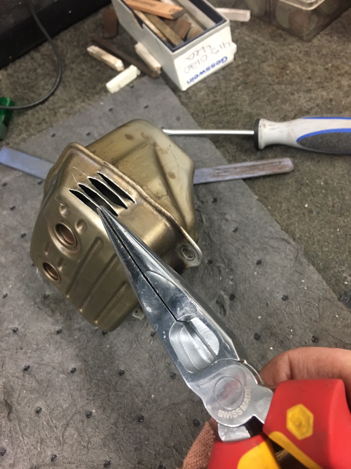

So I'm finally getting around to doing the muffler mod on my NON mtronic 261. I cut the gills in the left side of the muffler, took out the screen also. Is there any more that should be done?
What's the consensus?
I have same mod on mine and took screen out adjusted carb. Runs great
