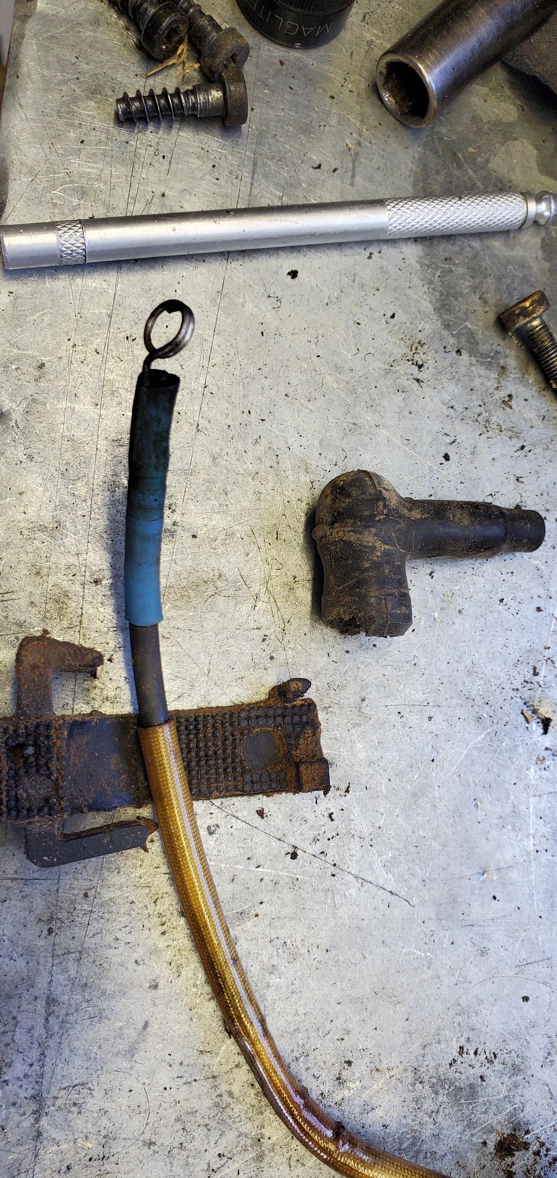

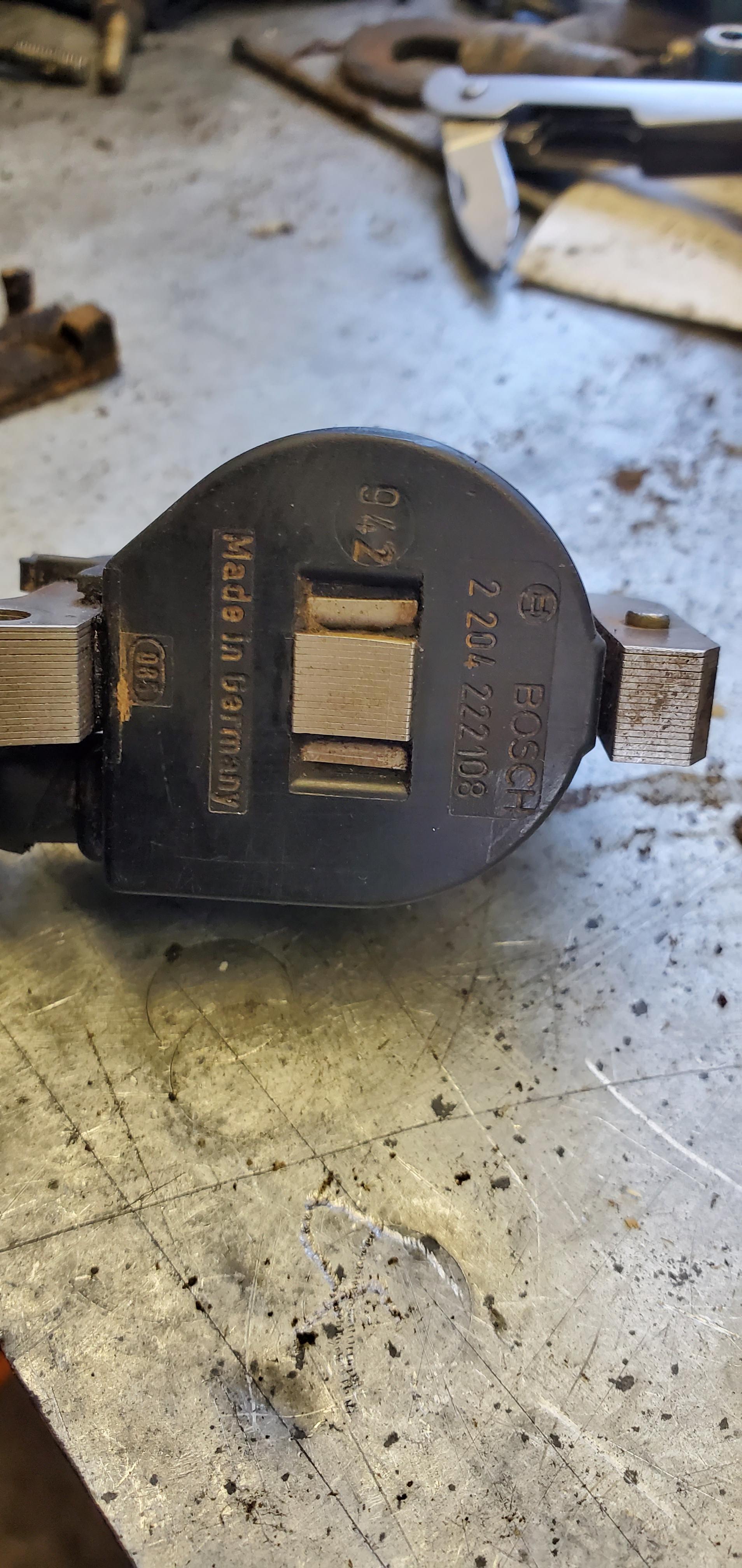

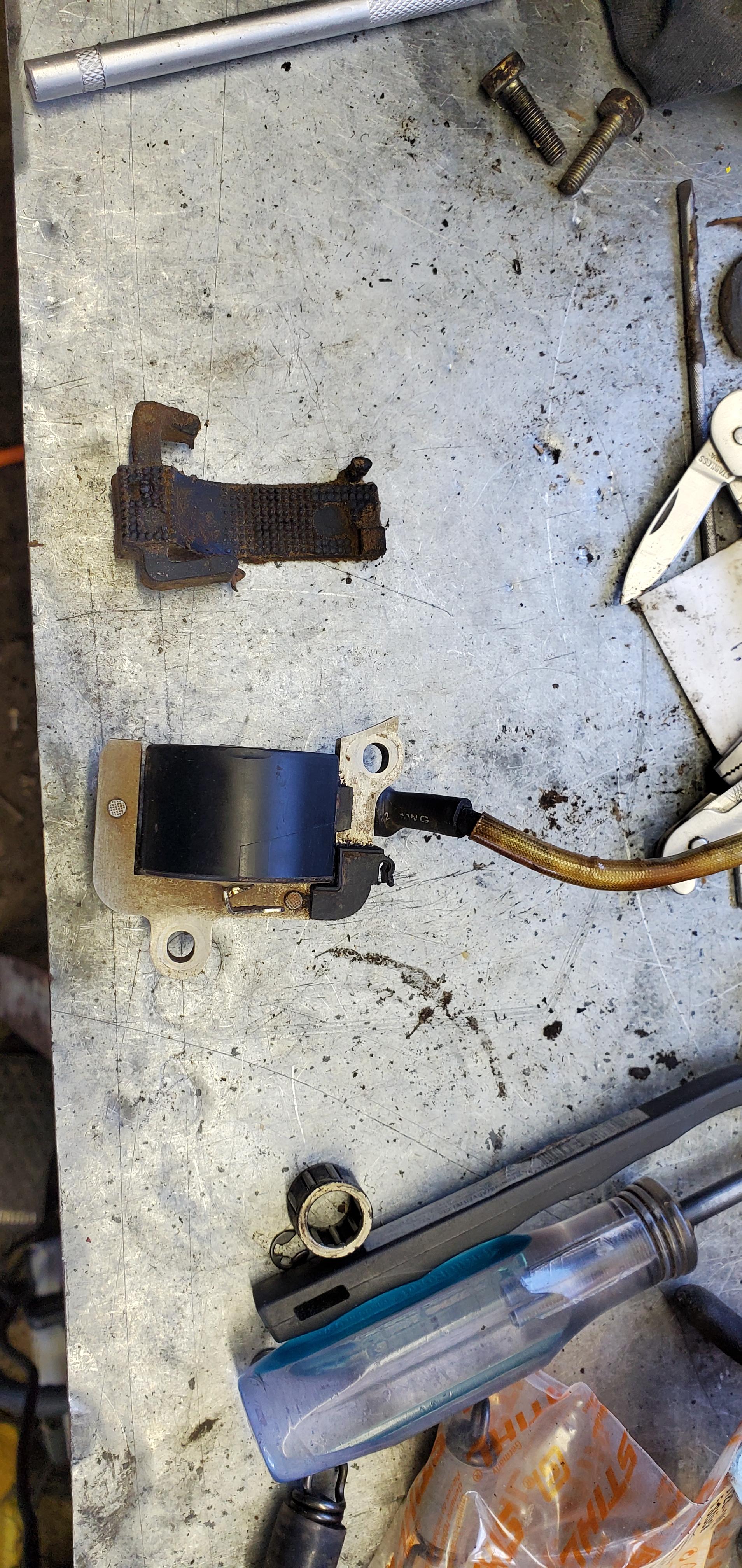

Hey there Kyle. I think I found the one you need. Part no. 1122 400 1300. Has the exact same Bosch numbers on the inside that yours does. The coil itself is good but um.....think the torsion spring and boot need replacing.
Sent from my SM-N970U using Tapatalk
Thanks, I can pull the boot and spring off my old one.
