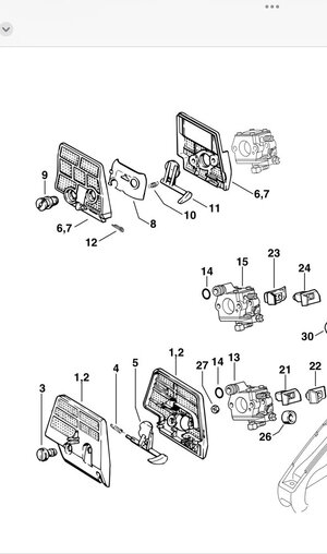

Don’t forget there’s two different air filters 😉
1121 120 1617 & 1121 120 1618
Iirc; The older 026 and the newer that is on the 026 and on the 260
Edit, the compensator carb top is the main difference, but the rear air filter cover is a screw or a leaver is the other difference
