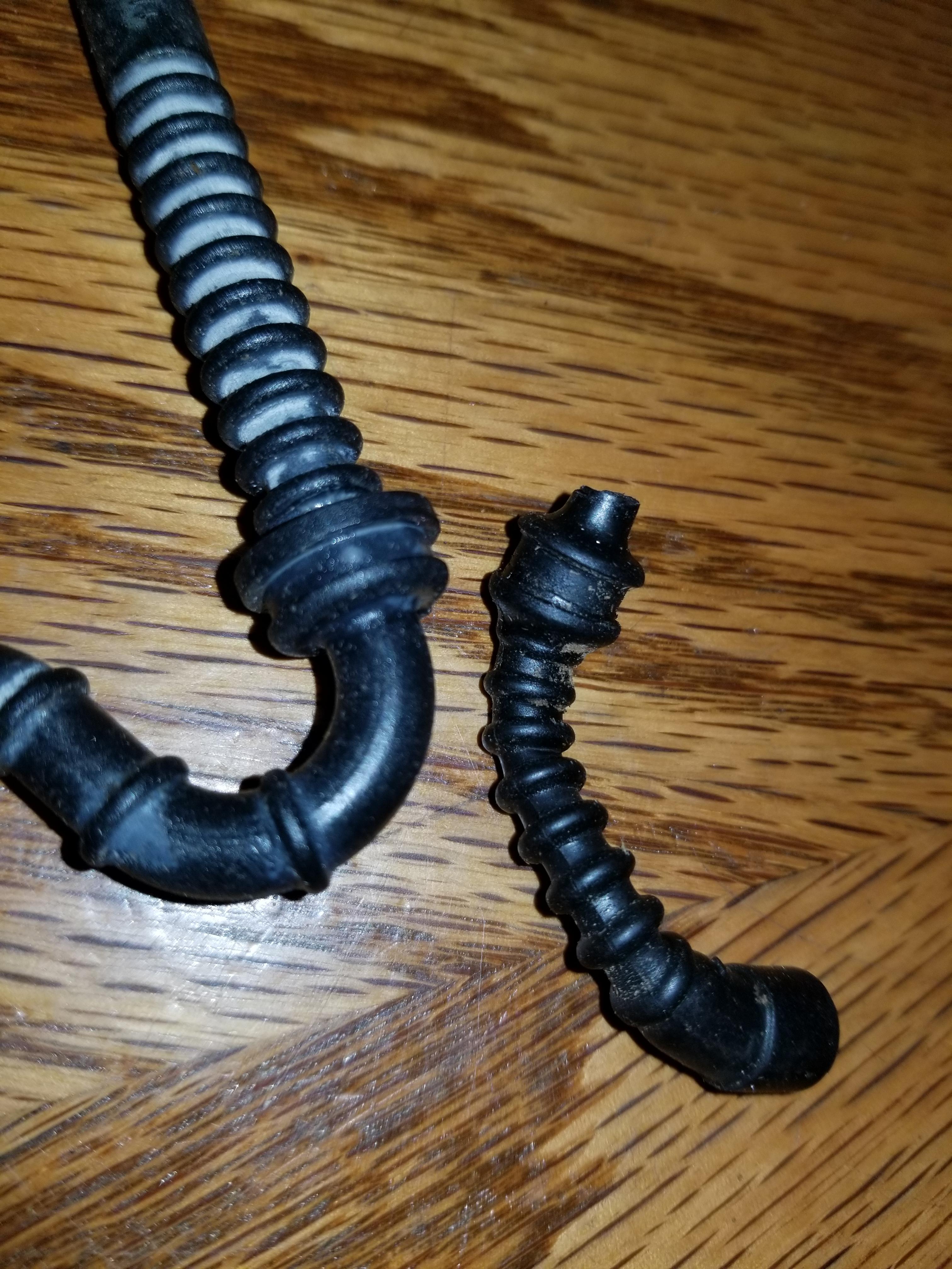

Just wondering if ther are 2 different fuel lines for the 026. The one the dealer got me dont look the same at the gromet area that goes through tank. Will get thenpart number once my boy finds it in the trash lol

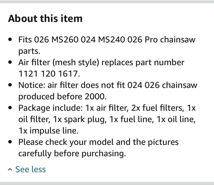

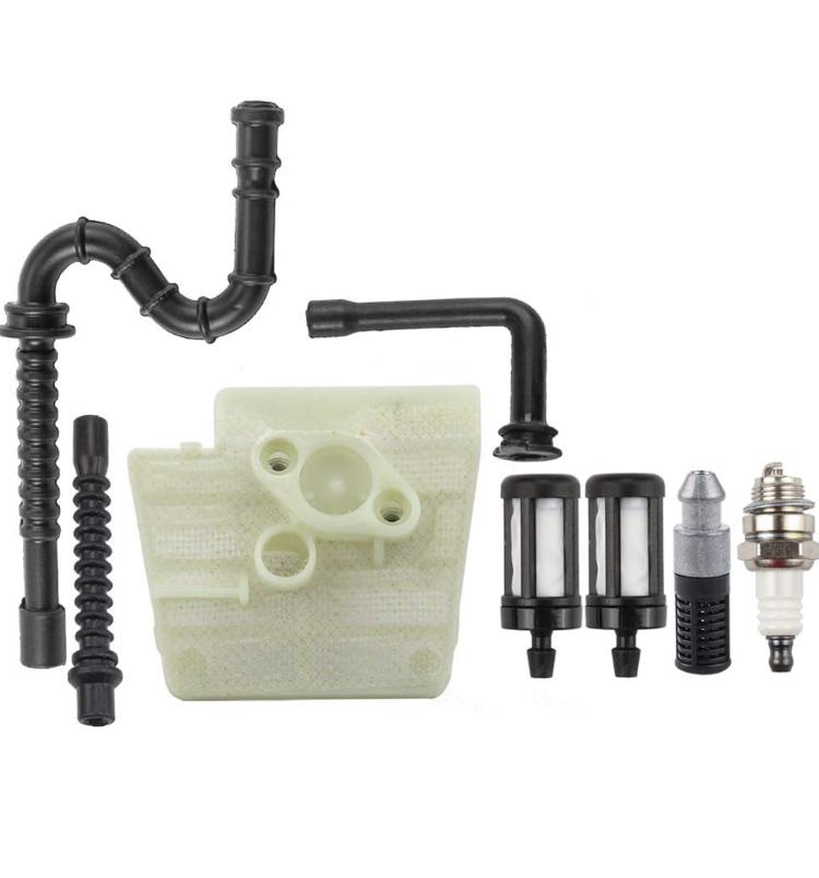

I have heard there may be a difference based on year made. Idk. Here’s a kit sold on Amazon which may reflect the line you are looking for.

original ones were straight and newer ones were the same as the 036 you will probably have to enlarge the hole in the tank for the new hose
some of the straight ones are on ebay at times

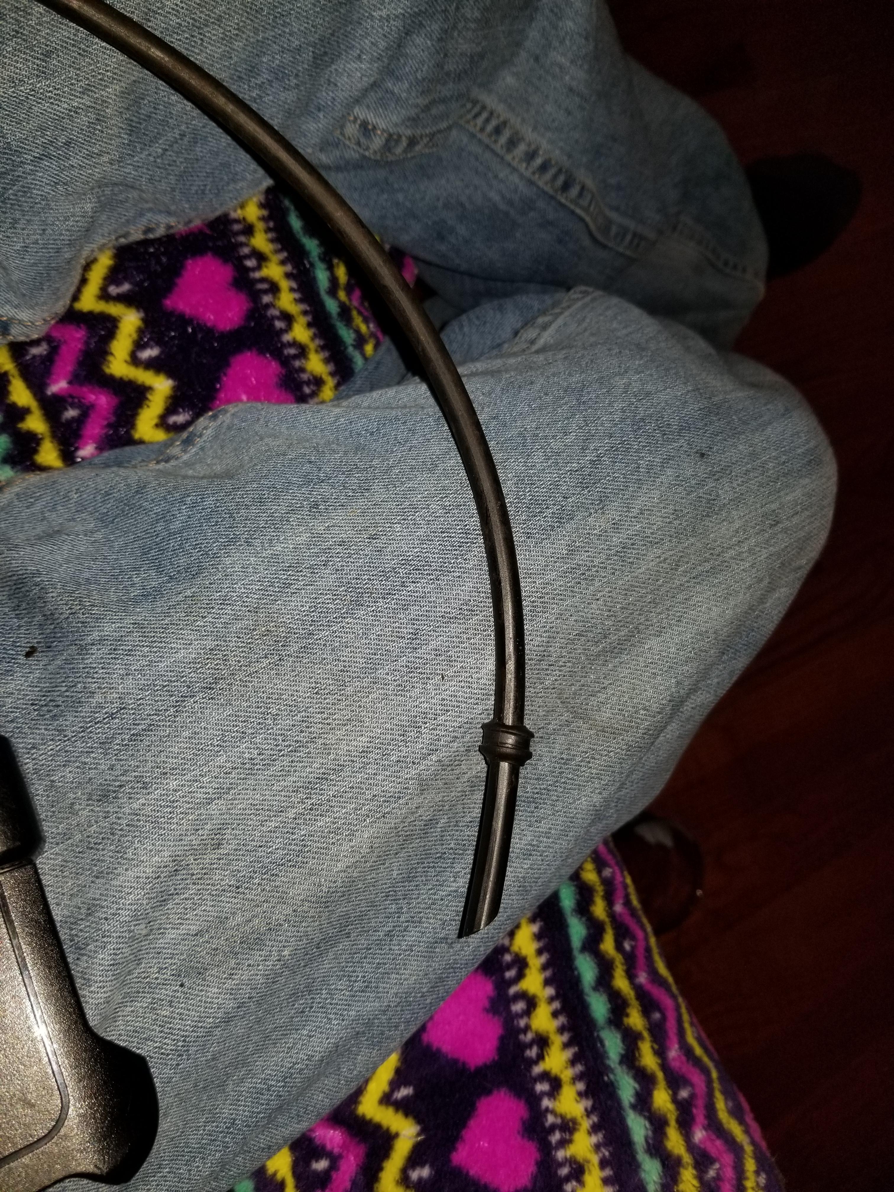

Well this is gonna be my attempt to fix the fuel line. I cut.the grommet section out, drilled it bigger and put a fuel line through it. Its a good tight fit so shouldnt leak. Will see if it works in a bit.

The earlier lines were straight and a bit short. The grommet was small as the one you pictured (most likely a lot easier to install and to remove also). The newer lines have a larger grommet that inserts into the tank -- a bit more difficult to install at times depending on what generation tank you have.I wouldn't waste any time on aftermarket lines such as the ones from Amazon -- the rubber is just not going to last. I've seen a number of saws rigged in the way you pictured. Use a quality fuel line -- like the black Stihl line and it will work. Make sure you get a quality filter as well. I really believe Stihl ought to redesign the line for this saw to be like the Stihl 038 line. That line has a tapered grommet and is far easier to install. My 2 pennies.

Like said above, 2 lines. The later S shaped one is the way to go, the straight one is a PITA and you can’t get the filter installed on it. With the straight one, I add a guide wire to it, and install it from the tank outward with the filter already attached. Just drill the tank and use the correct line.
