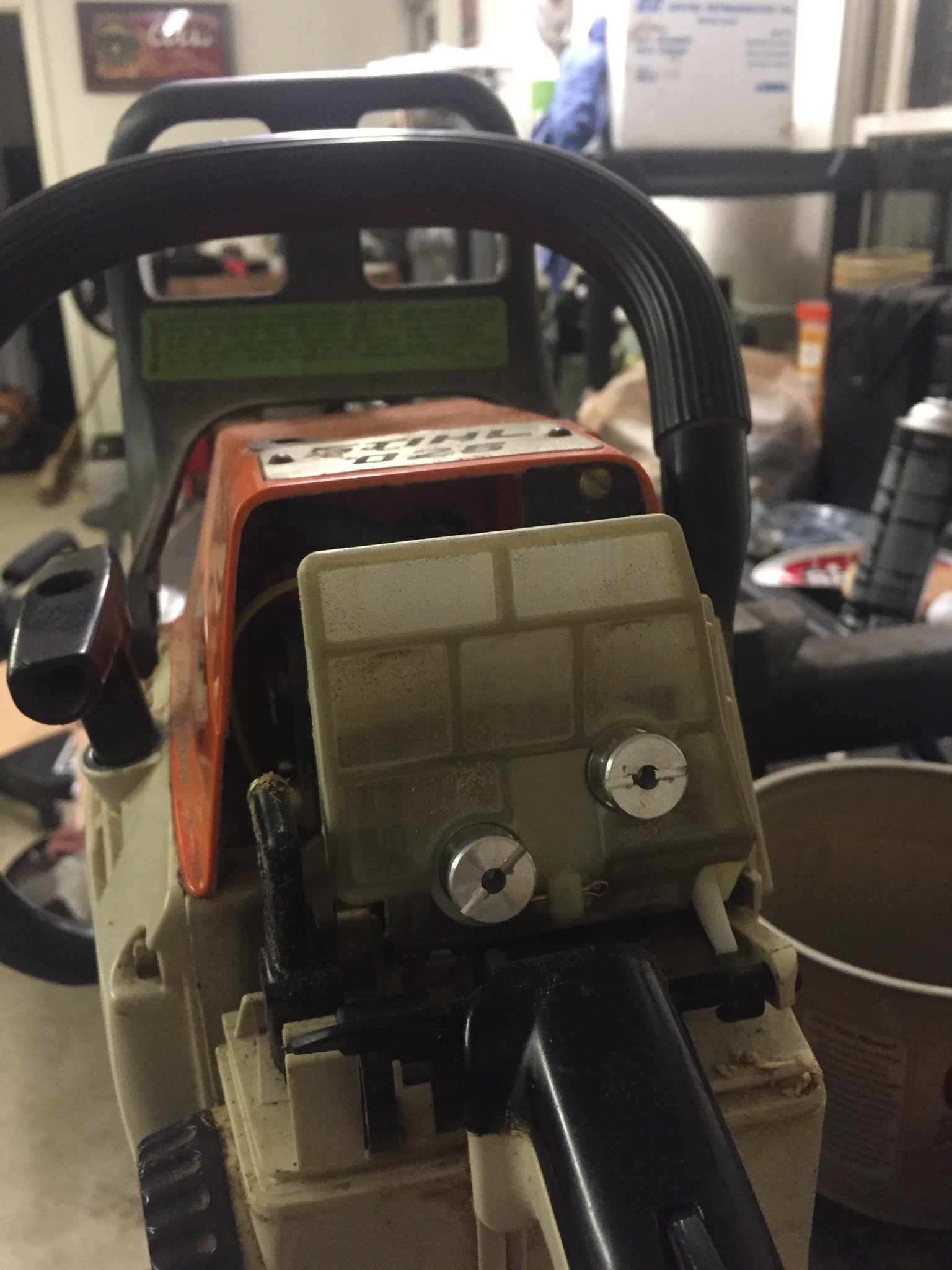

Here is a metal mesh that some tart was running on his 026 (me)
Ask around, I keep my saws crazy clean and this happened....You HAVE to split them and douche them out. I had been paint brushing this one and calling it good. Needless to say, I damn near soiled my trousers (Profanity Ban)IMG_1591.JPG

Here's the metal mesh filter from the eBay link above.
Wow!! I will keep a close eye on mine now.

I have a metal mesh on my MOFO 026. I actually wrap a thin landscape barrier mesh over it. It traps the fines better.
My filter looked a little like the one above. But I took it apart and cleaned it. Now I am much more aware. Lol
They are still good filters though. The metal mesh.
I will try and post a pic of the thin barrier tomorrow.
