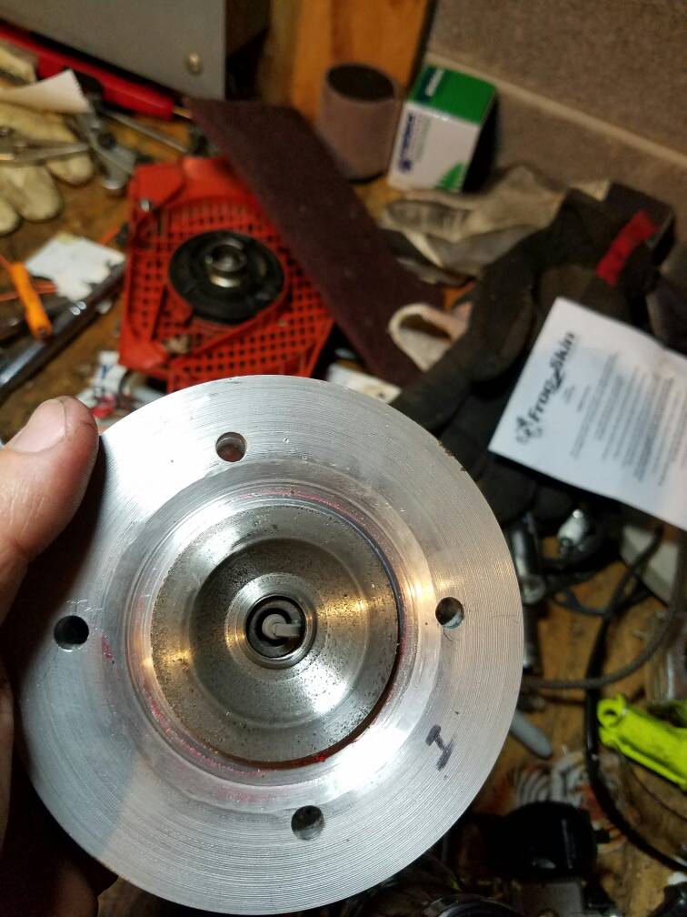

This one was .020-.021" cut by hand.

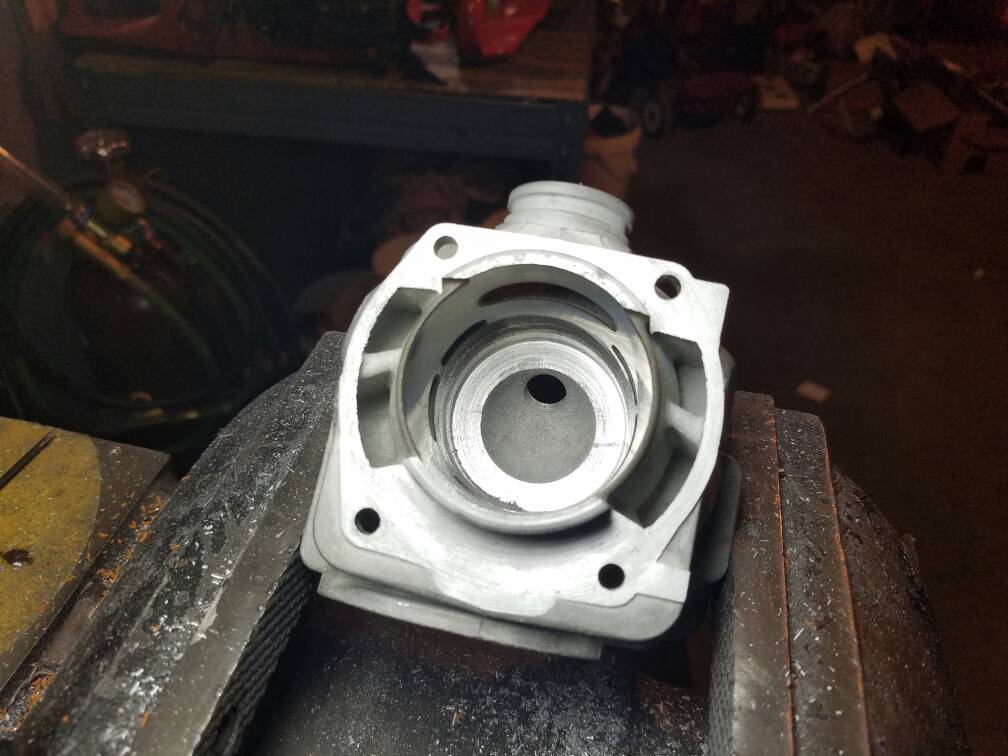

This one was .020" all the way around. Base and head machined so it should be.
