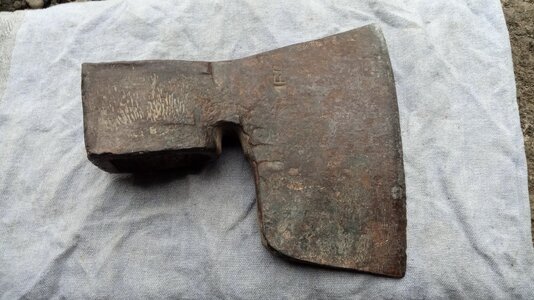

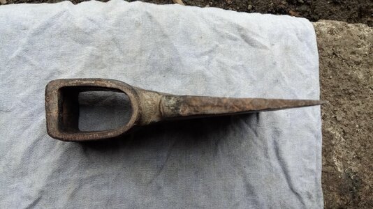

That axe is officially dangerous on both ends
Vampire killer stab & slash! 😅

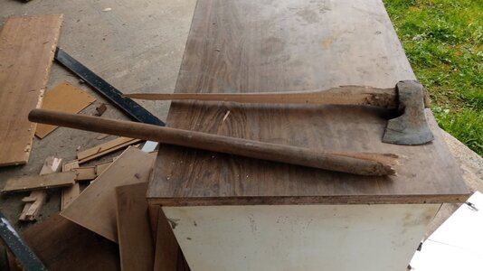

I have a couple handles that are too short for my Dragon Slayer, I'll fit one to this ax head.
Upon closer inspection that handle was a bit compromised by bug infestation, but it broke along the grain.

Looks like that axe is designed for chopping but not splitting. The void behind the lower part of the bit leaves the handle wider than the metal due to the taper of the head, which means the handle is going to take a beating on the leading edge. You can see it's taken a lot of impacts before it broke. Interesting design, though, just not the best for splitting.

You have not tried my Dragon Slayer, near identical profile but fully wedge shaped without the concave cheecks!
David is coming to Croatia to try it out and then start US made mass production. 🙃

It is a typical ex-Yugoslavian design, was well represented in the olden days when every village had a blacksmith or two.
Nowadays hardware stores push sales of slender near wedge less axes and beefy mauls.

She is ready to go back in action, got a 10mm alloyed steel top plate welded on as reinforcement.
I wish I could keep her, she looks like she may split rounds well.
1.66Kg after repairs
Lightweight, should be a fast swinger with good impact and low fatique paired with a 40" handle.
