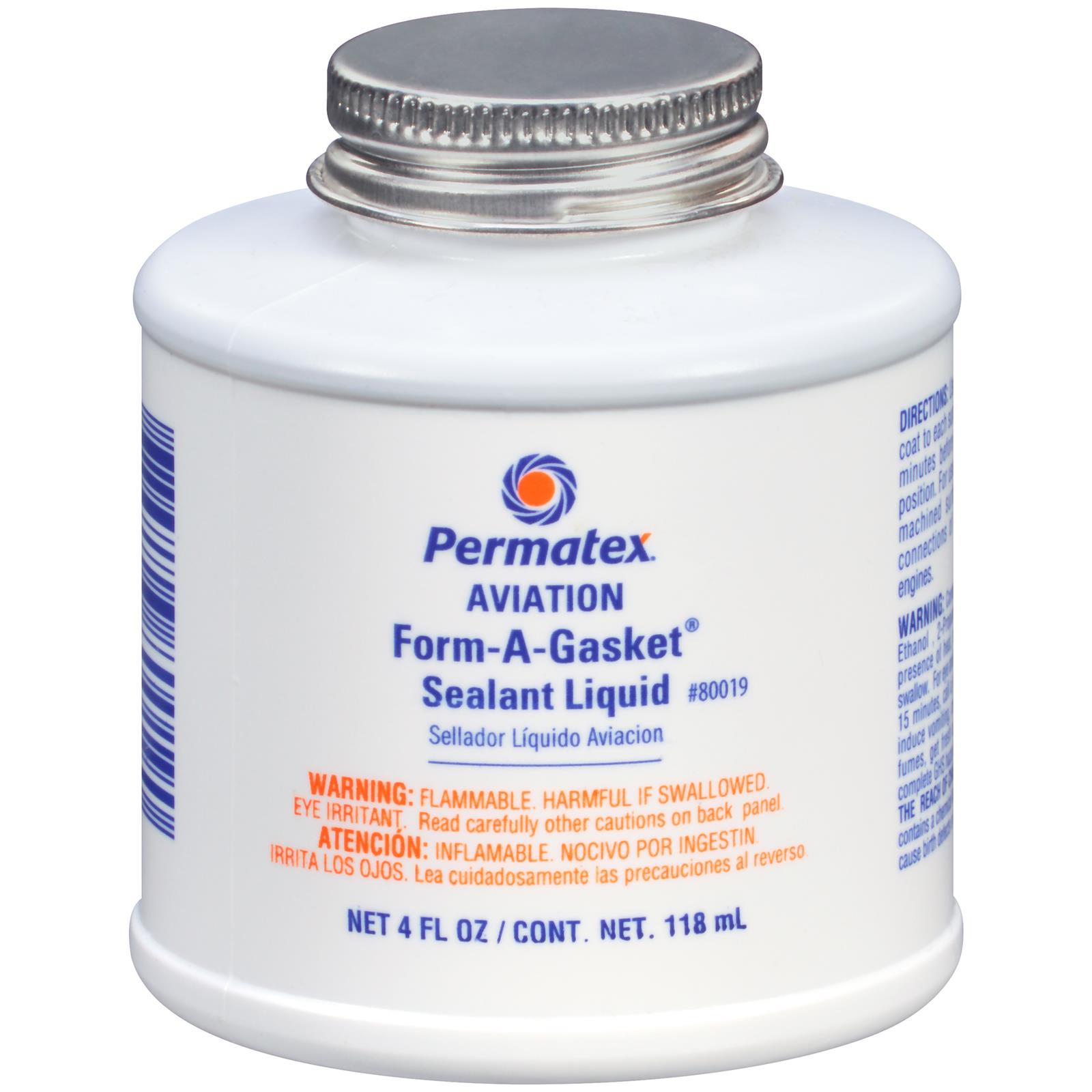

I use aviation form-a-gasket (Permatex) for gaskets (both sides), I think I have the red permatex I use with clamshells.

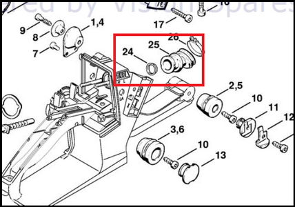

I noticed the carb body goes straight to the manifold, no gasket, on this 026 I'm building. Tempted to put sealer there.
If you have the elbow connector and sleeve (in good condition) you should not need any sealant. I have had and worked on a bunch of these style saws and if those parts are in good condition without any wood bits or dirt between them and the carb, the pressure of the carb against them will create a tight seal.
You might try the aviation form-a-gasket, if you goof, its cleans up easy, if you need to take the saw apart in the future it helps prevent the gasket from sticking and used on both sides of the gasket will help to fill in any unevenness...
