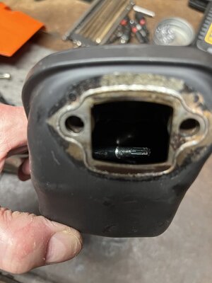

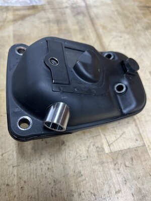

I dremel tool was used before , pipe was brazed , I do believe it did something, rather than nothing, have you done it ?

That pipe I put in is in the exhaust chamber below the small baffling, as you can see with torx screwdriver sticking threw the pipe, so the exhaust is totally blowing out the extra port pipe I put in , and has no restriction from baffle, seems like waste to cut open your muffler for no reason because there’s no restriction going on , IMG_1935.jpeg

I don’t know about the 562 , but there’s no issues with the 550 being restricted were the pipe is to cut it open like a sardine can, that would be a waste of good muffler.
