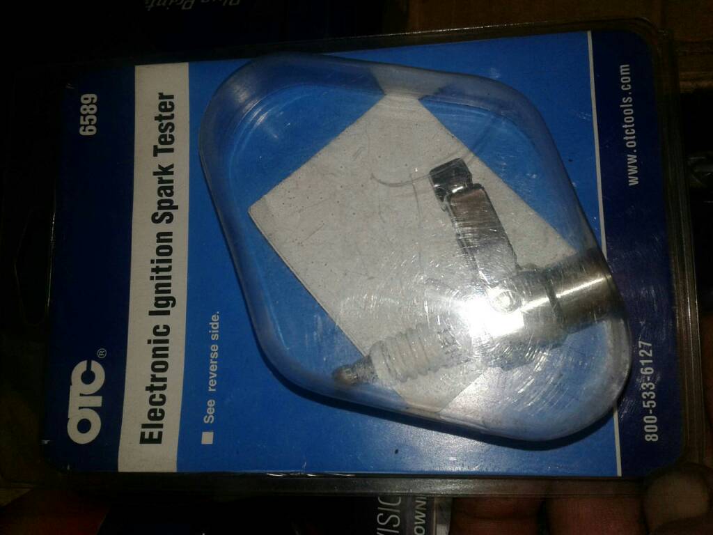

NAPA sells a good one that works great, looks like a spark plug with a heavy made clip on the side, use it at work also.

This is what I use, if it don't spark, you got a problem, has never let me down going 27 years and they still make them.

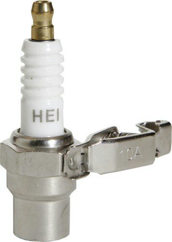

I have a couple of the stens ones. They work fine and let the engine run. Wont stress test the ignition system though. You need a gap type tester for that. Open your plug gap to about .050" and use the neon inline tester to do a psudo stress test. Saw ignition should be able to run at .050

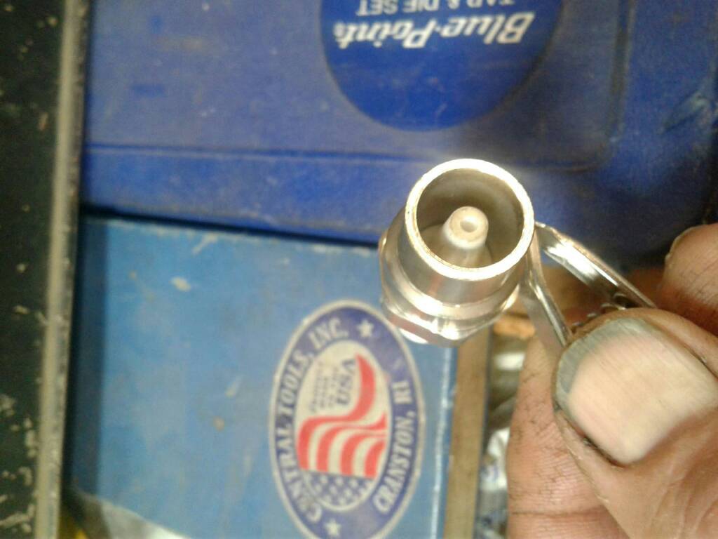

Picked this one up at NAPA, Mac Tools also have them. If it don't jump the gap, well you have a problem. Can also be used with it installed on a running engine to see it spark drops off when hunting a skip.

I had two cheapie versions of those that both ended up in the trash from the clips breaking off. And that type can't be used with a single cylinder engine that you want to do a running test on. Got this one from Auto Zone or Advance (or one of the other ones) and haven't looked back. Bulb and parts are serviceable. Just wish I could remember where I got it now! Good quality for one of those types of auto parts stores. Think it was around $15.

+1 I got the same one and love it. I got mine from O'Reillys
