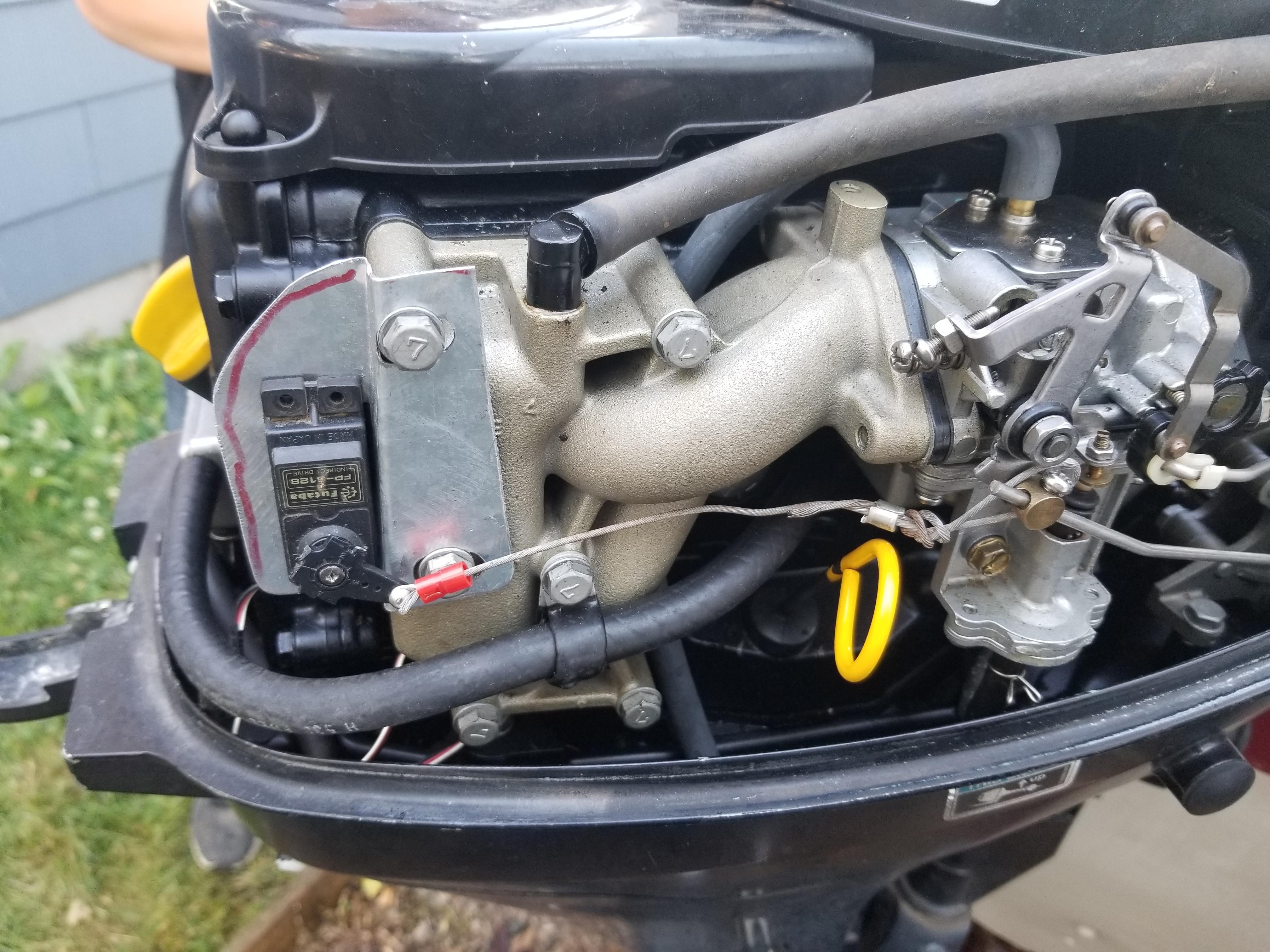

Rigged up a servo to the throttle on my kicker. After i tested it i ran the wires up to the helm so now i can adjust the throttle at the helm instead of having to adjust at motor.
I already had the old servo. Had to buy the speaker wire, servo cheacker, and battery holder. Might still buy a on off switch so i dont have to unplug the batterys. Cost is under 50 bucks.
