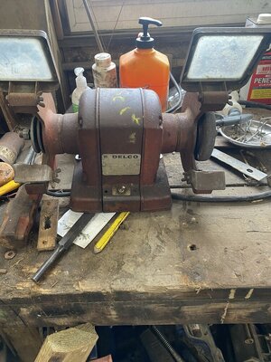

IMG_5422.jpeg5 inch wheel seems about right 1/2 arbor
I have another set up with wire wheel and course stone.
Figure I might sharpen some drill bits and wondering about wheels. Good wheel’s suggestions. Just general purpose grinder

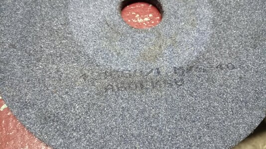

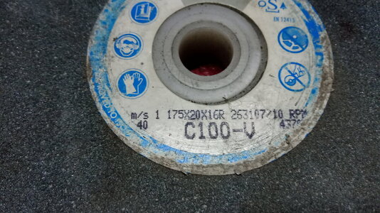

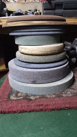

I just go by: white, pink, grey (coarse, for steel), orange, brown, grey (fine, for carbide) :p
I used to know to "read" a wheels composition specs, but I forgot all of it. :(
7:15 PM
15,011
59,916

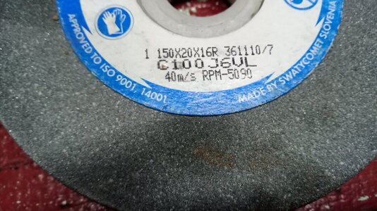

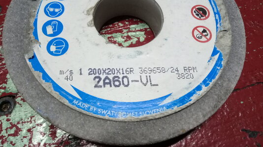

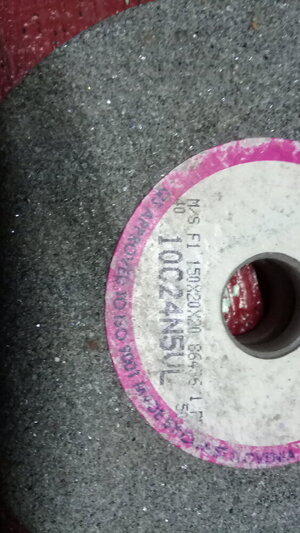

White wheel, good for HSS/SS
Grey semi coarse wheel, good for alloyed steel
Grey coarse wheel, good for soft steel
Fine grey wheel, good for Solid-Carbide/Tungsten/WiDia

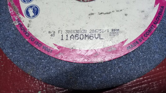

Wheel for belt saw grinding (high alloy steel, SS), works great on chainsaw chains aside from being a little bit coarse.
Doesn't "burn" the chain cutter as easy as a "pink/salmon" wheel
Kinda hard to read, Weiler A60LM6V

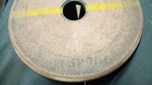

Gang saw grinding wheel, can't make out the specs.
I'll ask my neighbor to check on a new wheel.
Brown wheel, quite fine grit, haven't tried it yet.
