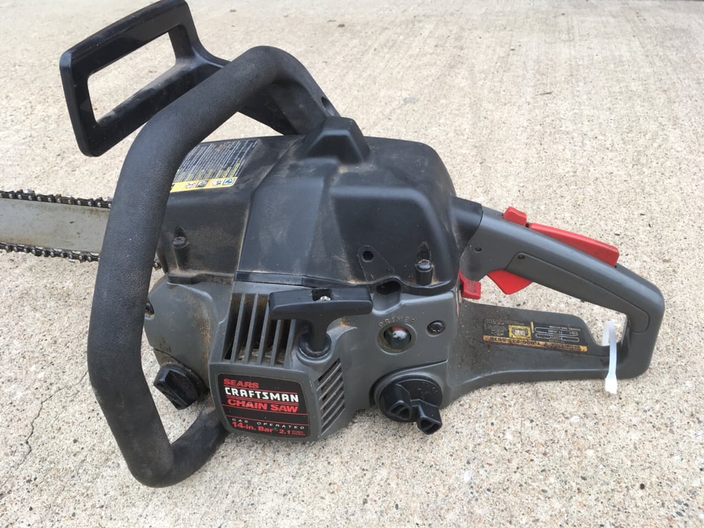

Oh dear, friend with a Craftsman saw
Duane(Pa)
It's the chain...
12:09 PM
325
5,142
25,547
Centre County
Yes, that's the broken fuel supply line that goes in hole under H-L screws. Pickup at end of that line in tank. And the other end attaches to empty nipple on fuel pump side. I hate the tiny .08" fuel supply line and drill that hole with 11/64" bit and use 3/32" for all 3 lines.
Wow! That worked great... The drilling went very well with no chips falling into the tank because the plastic came off the drill flutes in long ribbons. Fixed and returnt to it's happy owner.
12:09 PM
34,544
196,722
A Long hemostat and drill to whatever size line you use.
It's a quick easy job

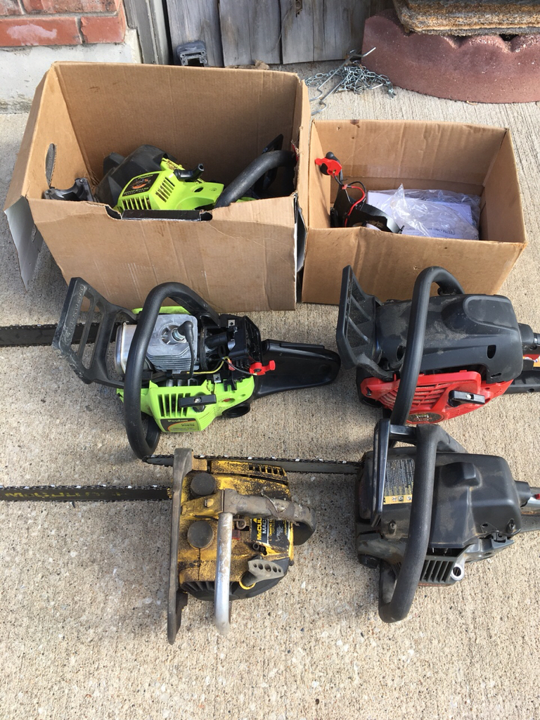

Plastic Craftsman/Poulans have their place.
I wait until I have a pile and then resurrect some for C’list fodder.
Two runners out of four ain’t bad. [emoji106]
Pus the leftover parts for the next batch. [emoji6]
Jon has been looking for one of those little yellow saws. times being such for him we should take up a collection to buy it from you and ship it to Mr.Fudim. I believe I can find his address. This would greatly lift his spirits.
What is the story on the red saw btw?
67L36Driver
11:09 AM
596
9,675
41,665
The Mac tophandle ain’t worth the cost of shipping. Free local pick up it is. [emoji106]
The red one (Poulan Predator), someone managed to break off the end of the crankshaft. [emoji15]
Near perfect piston/cylinder.
