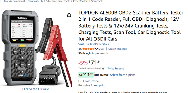

As of my searching so far, this one looks like a good value.

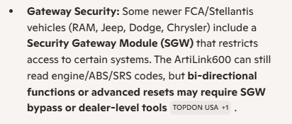

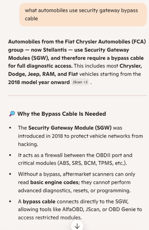

That's going to be iffy with abs if it does it at all.
I do need to do more research. In my AI research it seems that Ram has created a layer (SGW) preventing advanced diagnostics for the DIY Owner. First off I don't even know how much indepth diagnostics I even need, so that has become part of my research. Gets a bit confusing fast.

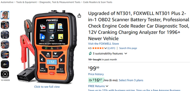

I got a Foxwell a few years ago, specifically to do ABS and airbag diagnostics that my older Actron code reader wouldn't do. It looks like they've upgraded the models (probably several times since then) but I've been happy with it, and it does ABS/airbag diagnostics well. For example, I was able to figure out which wheel speed sensor was acting up on our Jeep Patriot when the dashboard lit up like a Christmas tree with ABS, ATC, 4WD, and BRAKE warning lights. Try figuring THAT mess out without computer diagnostics. Replacing the sensor and clearing the codes fixed it right up. So, whatever you buy, I think the ABS and SRS capability is worth the money if you're driving modern vehicles anyway. If you weren't, you wouldn't need a reader, though. ;) :D
