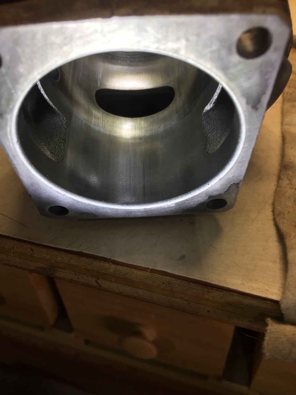

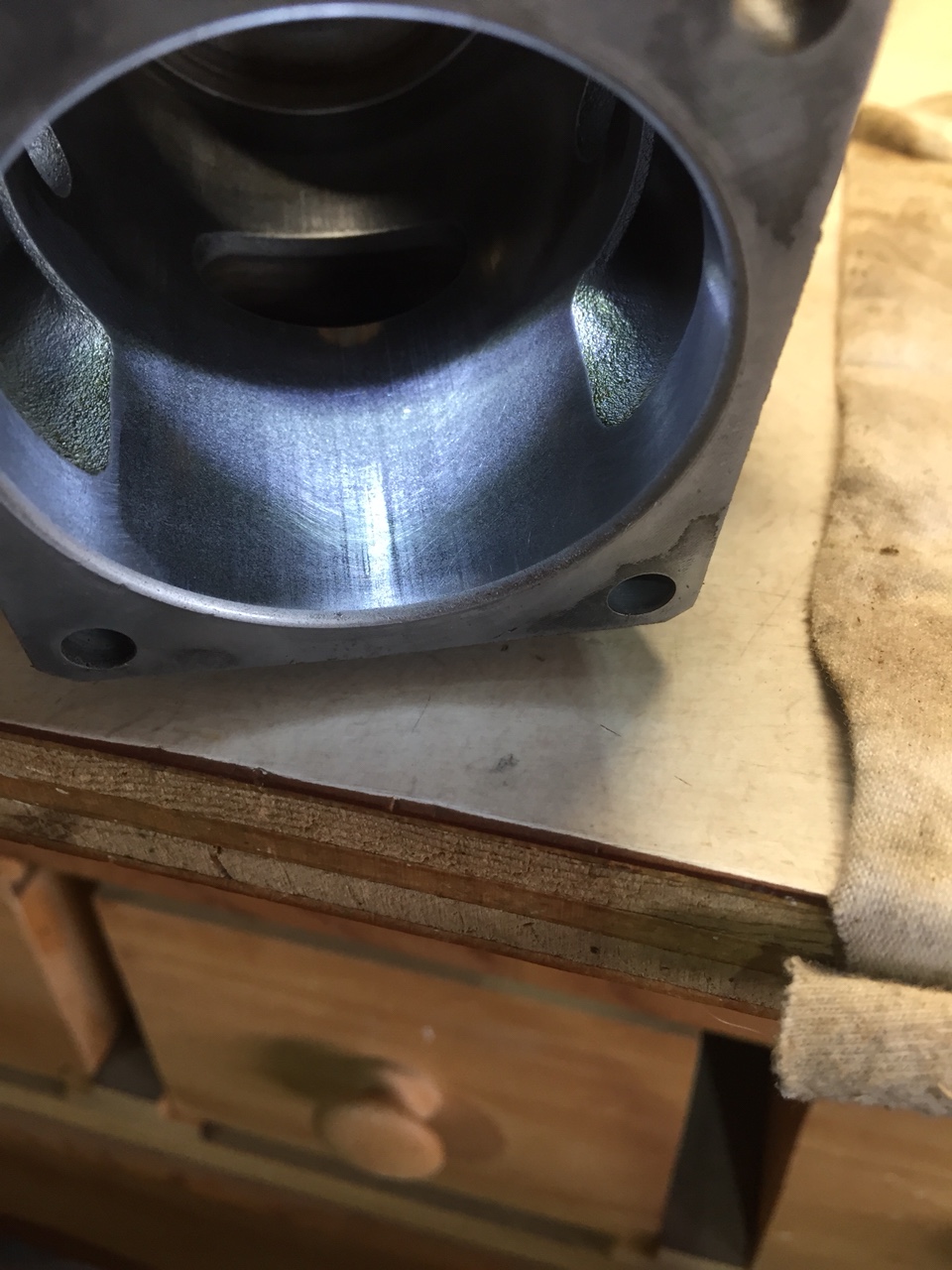

Yeah. I figured the cylinder would be a total loss but it might clean up. Fingers crossed.. will know more after it comes out of the ultrasonic.

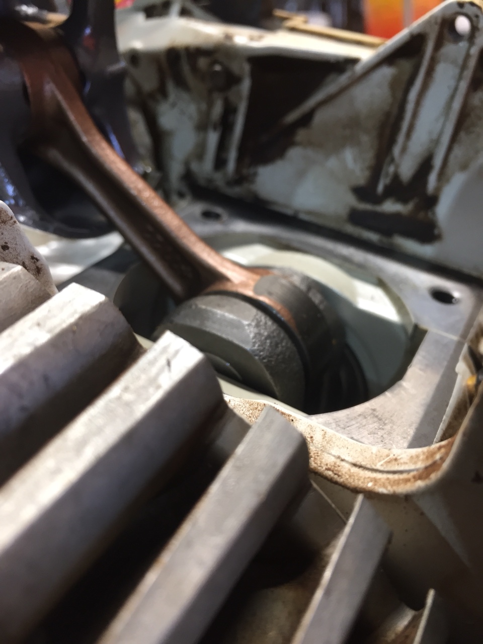

I’ve never seen crank halves so uneven?

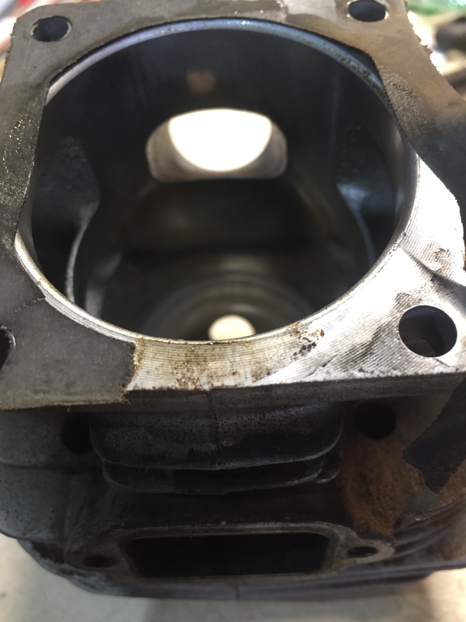

The dirty spot is where she was leaking

I wouldn't let that crank throw ya. I'd be more concerned of warpage at the cylinder base, there's a reason it chose right there to blow out. A piece of glass and sandpaper should tell the tale and if so, continue until flat. Just go in all directions, not just one.

I checked with a small machinist square looks ok.
The break in gasket was at case halves. The case half gasket was not trimmed flush they just put base gasket on and figured it would squish I guess. I would say poor assembly [emoji50]

Pretty amazing what two seconds with a razor blade will do. :rolleyes:

IKR pretty disgusting at the piss poor work. Had to be at factory. He bought new has never been apart.
