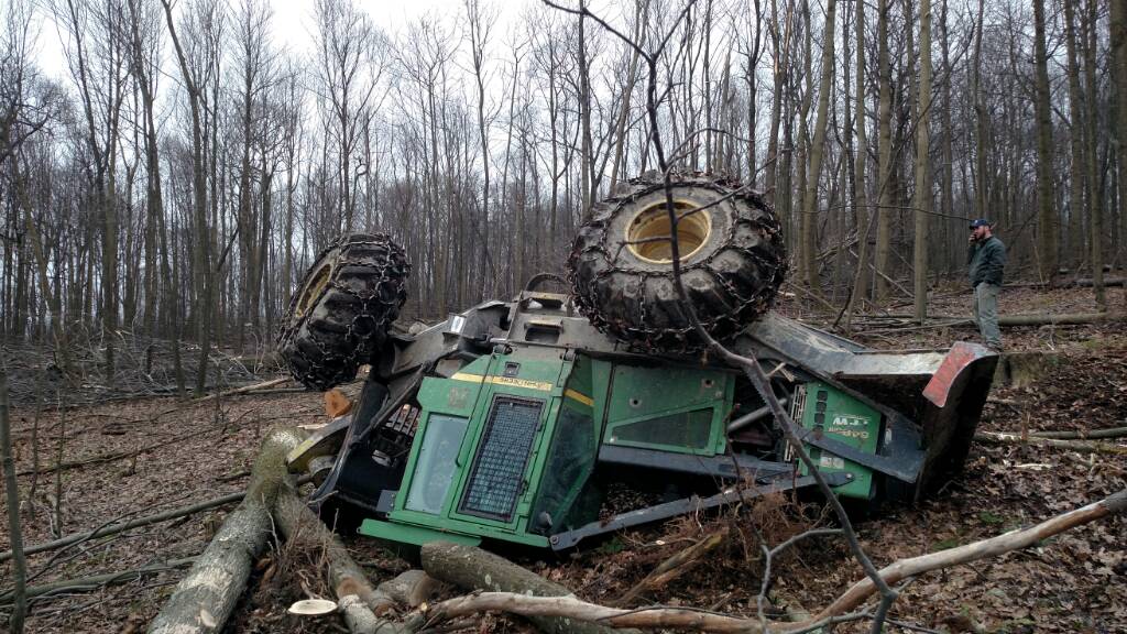

Keep in mind that on hardwood timber the most valuable wood comes from the first 12 feet. With a Humboldt your going to have a higher stump leaving some (not really that much if you'd take your time and notch low) of the most valuable wood on the ground still. Low stumps are your friend. Skidders are near magnetically drawn to high stumps it seems. This is the result of hot dogging and trying to turn around going to fast and putting the high side tires on the high side of a stump on a slope.
The stump the guy is standing on is the one that rolled him. It's even a low stump.
