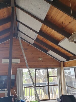

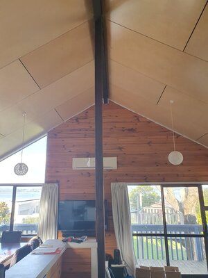

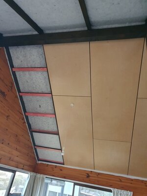

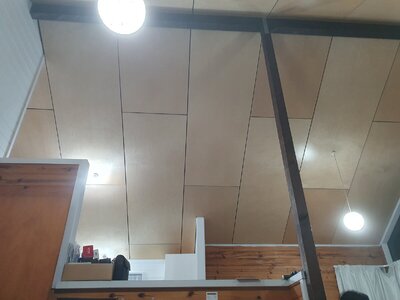

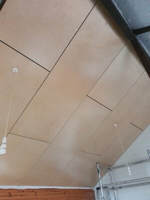

So this house...
Concrete roof tiles, on 2x2 battens, on foil, on 10mm (3/8) t&g pine sarking, on 10x2 rafters.
So basically no insulation.
The winters aren't cold and a 7kw inverter ac kept up, but in summer the tiles would send an ovenlike heat in to the upstairs living area. I shot the t&g with an IR gun a few times and got 50c (122f).
Thought about lifting the tiles and putting super compressed foam in. Too dear for the R value.
Settled on filling the rafter bays with 165mm (6.5inch) polyester batts, and putting a negative detail pre-finished ply on as the ceiling.
Did a lot of prep myself, kinda wished I'd done it all but a man has to know his limitations. Unfortunately my General Contractor didn't send @John Wargo or @Agent Smith over. Some of the detail isnt quite what i had hoped for, but this house is none of plumb, square or true.
I did consider drywall, but as demonstrated by Maulheads disappearance, those guys aren't too reliable (actually didn't want sanding dust through a house we still were living in right through the work).
Anyhow, it's much warmer and cooler now. Not to mention brighter. I raffed when Andy showed his log cabin getaway pic, we are so sick of honey coloured timber after being here for 23 years.

Looks good Adam. Is there not any vapor barrier on the insulation?

Great work Adam. Insulation investment is always worth it. As far as the stained wood look goes - I think it’s timeless, but I see you disagree lol

We lived in a house with knotty pine walls and ceilings, after awhile it gets old.

I think having drywalled and painted walls, with the wood ceilings would be a good combination. With all the walls and ceilings both done that way, I could see that getting old.
