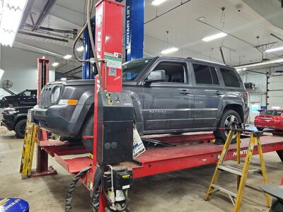

Take this Jeep Patriot for example..
Who knows your Jeep? Your GM dealer, that's who.
They bring it in and have our new alignment expert Brandon line that bish up. I mean, he took a 2 day Hunter alignment course, so he knows everything.
Well, after, a service writer and him determined it has torque steer. They then find the right control arm bushing that's no longer connected to the control arm.
They dump it on me to replace the control arm, which I do. Steering is now crooked as fùck. And, I noticed when I drove it the left front cv shaft is knocking like an I80 lot lizard on a freightliner sleeper..
So they have him do another alignment.
Then dump it back to me to replace the CV shaft..
I replace the shaft, road test, it pulls like a mutha ro the right.. but I wouldn't call it torque steer..
So, I look at the alignment printout.
3.2 degrees left caster.
2.1 degrees right caster..
Anyone who knows what the angles actually do know it's going to go to the side with the least amount. Us, factor in road crown. I like to see .5 degree higher on the right, or so, to compensate.
Tell them maybe they need to look at the angles as a hint.
I got told "they are all in tolerance " in a slightly snotty tone.
I said, that's cool, your the expert.
He's been doing these 3 months or so now.
I did my first alignment in 93. I might know something if they'd listen..
