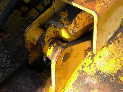

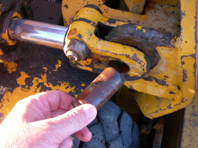

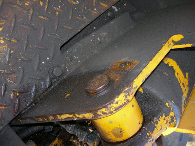

I blew a seal last week.....
Front pins came right out.
Rear pins will not budge, thoughts other than welding a bolt on it and using piece of pipe & washer as a puller?
Already tried heat and a BFH, it's not budging.
Grind down the flowered edges of the pin on both sides as they look a little deformed. Then alternately heat both ends of pin only not the bosses until the pin is red. Walk away for an hour or two. You may have to lance out the pin center if it don't free up. It looks as if the barrel is in a weldment surround on that forklift. Is dis-assembly on machine a possibility?
Completely agree with Tim here.
I will add to spray with your favorite penetrant before and after heat cyles as a way to loosen rust, if thats the problem.
Ive also had luck with medium heat, then spray once penetrant doesnt steam off, then tapping with soft(brass) hammer if its accessible. If you can get it moving from both ends, then work back and forth. If you have the time, sometimes less is more.
Its stuck because its either rusted and swollen, or worn and mushroomed in one part of the bore.
Penetrant helps with rust.
Heating the fuch out of the pin and beating the lip off is the only hope for a worn pin that has a lip/shoulder.
Otherwise, airarc that bish out. Cant be a problem if its liquefied and blown into the next county.
Maybe a dumb question, but do you have the mast cribbed at the bottom and braced off at the top to take the load off the pins?
If not, then thats why they wont come out.
