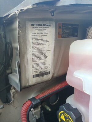

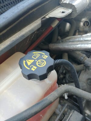

What in the hammer-headed hellz is the general/International attempting to do here?
I just want to check the fuggin coolant FFS.
Operators manual is about as clear as mud.
View attachment 370606View attachment 370607View attachment 370609
The lower part that's empty should have 2 quarts in it..
Yeah, top cap is right hand thread.
If you remove it you'll see a tiny hole off to the side.
You can fill the lower part through there..good luck.
Or remove the reservoir, remove the cap on the side and fill through tiny hole there..
Looks like on your medium duty you can at least access the side cap without removing the tank.

So the lower tank should have 2 quarts in it when cold?
I can get a flex funnel in that lower cap and fill it I'm pretty sure.
Thanks Ed!
Thanks Ed!
Yeah. We replace quite a few tanks for the level sensor taking a crap. Supposed to add 2 quarts to it on install.
