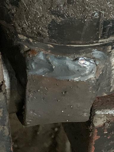

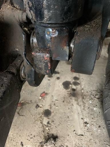

Dad broke the ends of the lift cylinders off, don’t know how?!
Kinda piss pour design anyways
Took some 3/8 stock welded to one side then put the pin in and heat and bend to form then welded to other side
