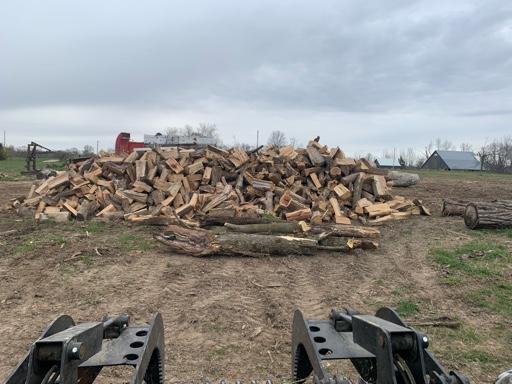

hoskvarna
1:32 PM
376
10,648
60,610
Iowa
Out doing more derecho cleanup around crop ground to add to the pile
Sent from Hoskey hilltop
