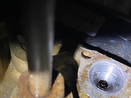

Working on boys 02 Silverado
The abs block in front of fuel tank, rear brake line won’t seal after closer inspection the nipple that the flare seats against is damaged
Any way to eliminate the abs bs?
Zoom in and see damage
Sent from Hoskey hilltop
I have never eliminated it.
I'm guessing it could be done, but you would need to bend up all new lines, easiest would be an adjustable proportioning valve and might need a master cylinder swap. Lights would be on the cluster too.
It just won't seal no matter how tight you get it? I've seen a few that were pretty ugly but still sealed.
You could try a nickel/copper line. Unfortunately you would have to replace either the whole line or section it and do some double wall flaring, but its a softer material that might seal up better against the irregular surface.
