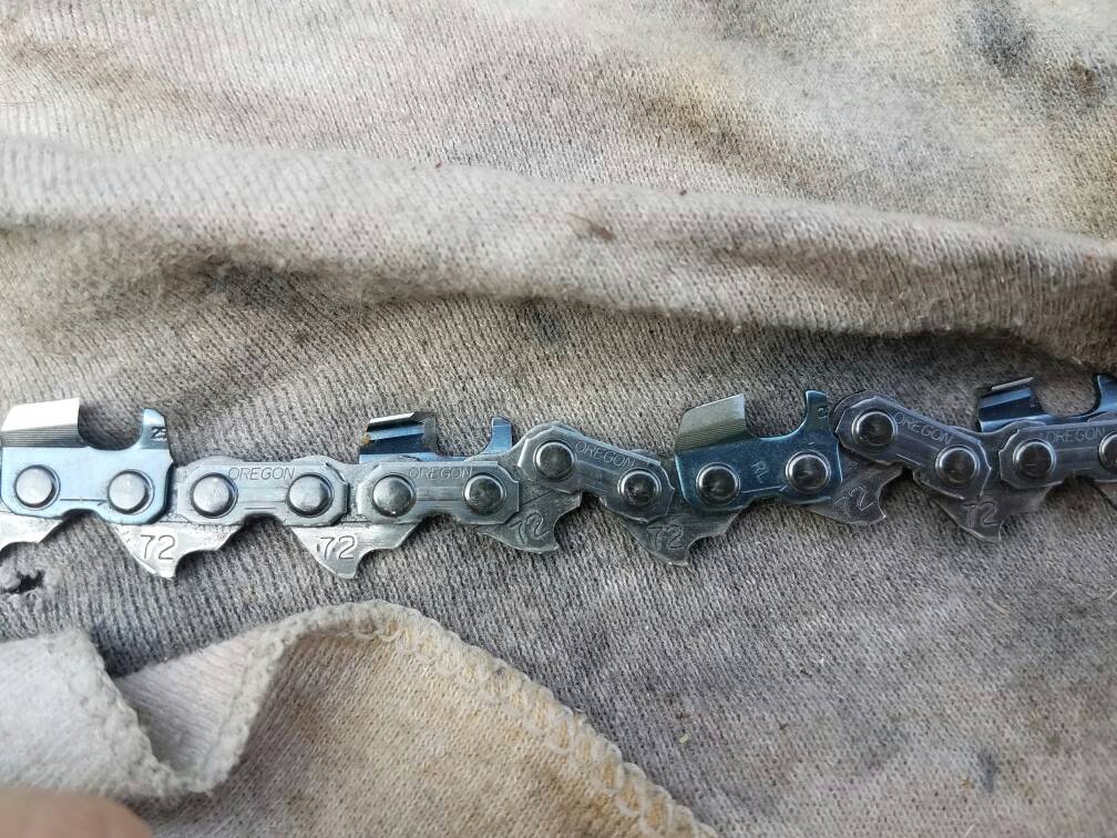

So to do the "clipping of chains " are you just setting the grinder a 0?

Could you do a slight modification like this and improve results for the everyday user. How would this chain run in a hardwood? Lets just say you wanted to modify a chain for improvement of saw efficiency while working not playing. Maybe a little bit of WOW factor around your buddies.
9:42 PM
147,462
You could. When boring a lot cutting the heel helps smooth it down
Thats what Iam looking for is bore cutting improvement. We only like to take trees that are dead standing or close to it and would like to give some a little poke before hacking away at it.
