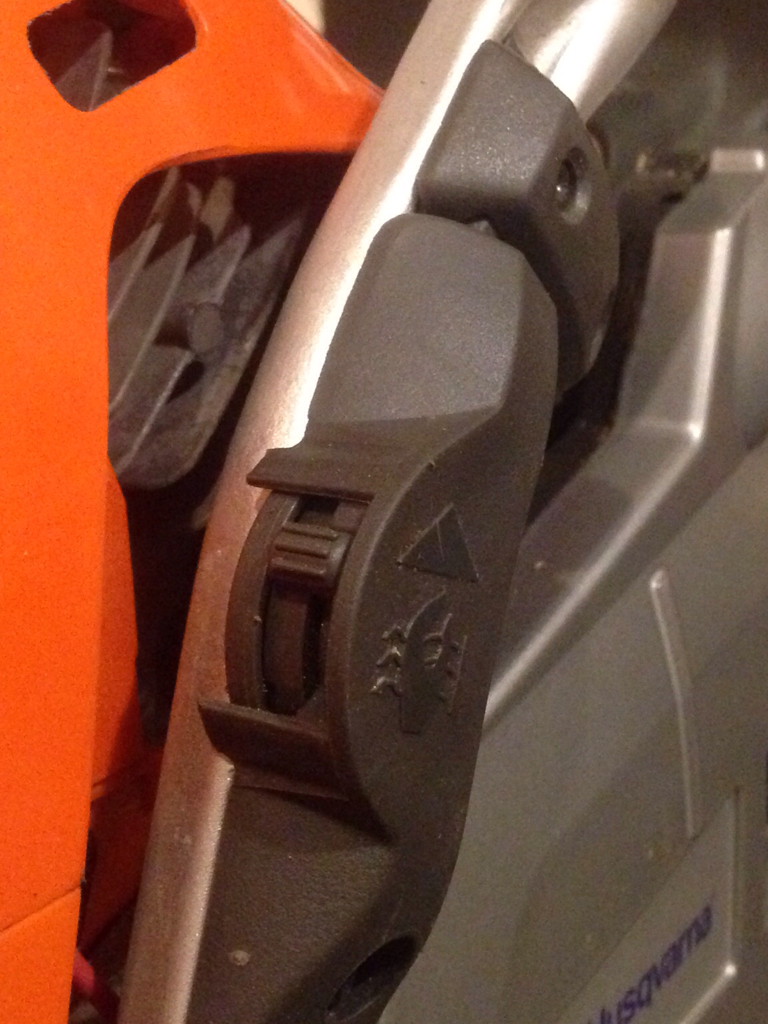

I read were husqvarna modified the 550xp top cover to provide more ventilation and cooling.
Can anyone post picture of the new and improved cover?

That's a 346, I would like to see where u could put one on a 550??

Only pic I could find.

It looks like there should also be a small vent above the muffler deflector plate on the cylinder side.

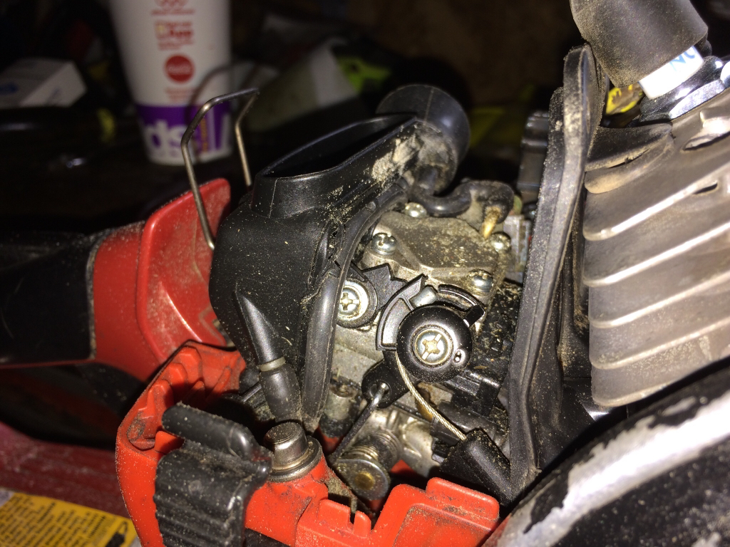

I think part of the problem has been overlooked. Look where the fuel line lays from the tank. When the saw is shut off the supply fuel is trapped between the carb and air filter with heat soaking it.
I don't do it, but the manual does state to purge before any start. This would move cooler fuel through the system.
A better design would put the fuel line towards the bottom of the carb compartment instead of the hottest area of it.
