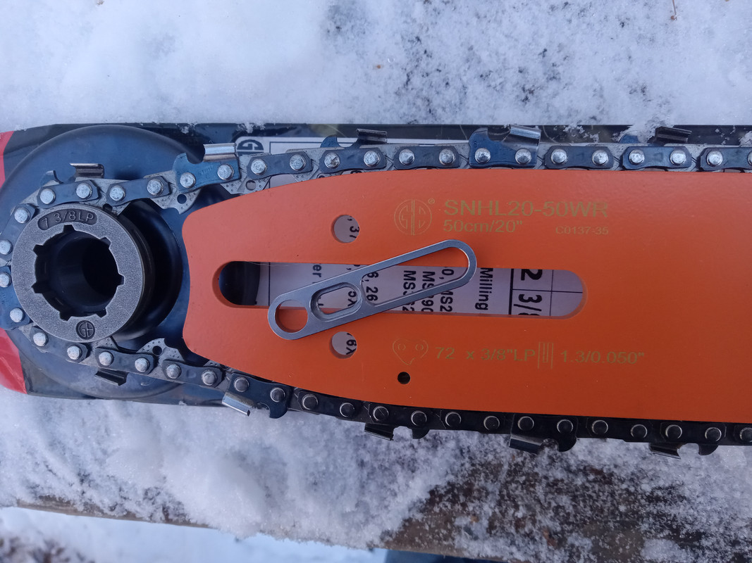

Those little safety bumps on both those .325 chains, bind up with wood dust against the drive links. Especially on smaller cc saws, the extra friction slows em down.
Try a gb narrow kerf bar with a loop of 63pmx and a loop of 63ps. Will need to run a bar adaptor and a gb 3/8 lp rim sprocket. Both would slap that goofy husq .325 safety chain silly. The pmx will retain sharpness longer.
These 20" bars are so dmn good, I get them shipped from AUS to Alaska for milling with the g777 small mill. The pmx chain comes from logosol-sweden.

I have run a 3/8LP setup on this saw in the past but went back to running a 058 hard nose bar because it oddly prefers to run full size 3/8. Its main use now is cleaning up all the small stuff and the 325 chains are really good at that. Got a good deal on the husky bars and wanted to try the NK setup so this is mostly for my on curiosity.
