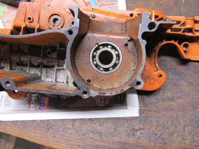

I didn't notice this before. How does a guy fix this hole?

Did someone run an oiler bolt in that was too long? If so, putting that bolt in with plenty of loctite on it should be a good enough seal, if the threads are fine.
I was wondering that.. this is what I get for trading and not paying attention..
