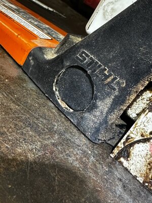

Crack in tank above fill explains leak. Sounded lean the other day…yeah 3800/15000 lean…gotta figure out how to bypass the limiter cap. no drums available locally, probably order the separate rim upgrade. Sharpened the chain on my USG, cuts good.
erratic tension is what precipitated working on it which is why I running with cover off. Seems to work ok that way. Maybe for some reason with the cover on the chain wanders over to an unworn portion of the sprocket and gets tight…
not a lot of what I assume was the chain Catcher left

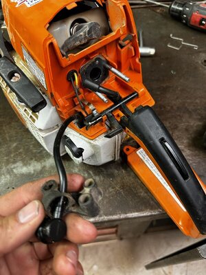

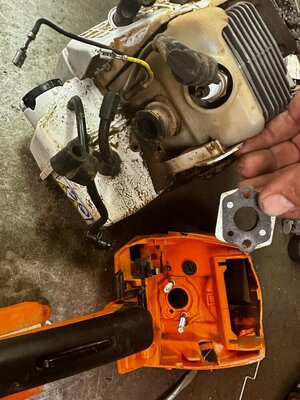

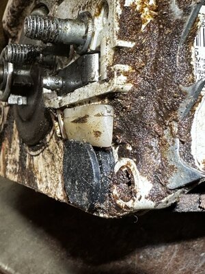

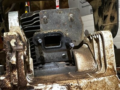

…yet here I am… NOT a fan of this thing.
Lines are pliable and hold vac. Piston is clean. Saw Doesn’t seem old.
Messy due to cracked tank. Slightly busted air filter…saw dust into saw thru impulse into carb?
Haven’t opened the zama yet. Is there a test for accel?pump n check for squirt like a car?
Ref pics for me and the next unlucky jerk.
CD775816-253A-4355-9303-E00767E87F30.jpegA0F459E3-1DD5-4B3E-822C-D6ECA6EA5BF6.jpeg6FDE3F22-14D5-49FB-8823-5AA3CEB114C0.jpegFC827F2A-AABE-4110-80F8-E2EA16BE560C.jpeg

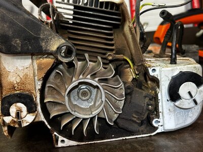

Passed press n vac. Runs. Maybe all it needed was the tab trimmed off the L. I didn’t replace anything in the carb, didn’t have gaskets. Diaphragm questionable. Still tunes a little weird on the L, never gets blubbering stalling fat. Can’t add in idle speed…so maybe still a slight lean condition. BD904C45-6FDF-4813-ADFB-82382AF0A1C7.jpeg
I think I got something wonky with the AV mounts. All I did was remove and reinstall the screws but one is proud and one is deep. 🤦🏻‍♂️70770CCD-9403-4499-86BC-8F0C85C41546.jpegD8B4A84A-99C3-4151-B0FD-E0DD1DF6B16C.jpeg
