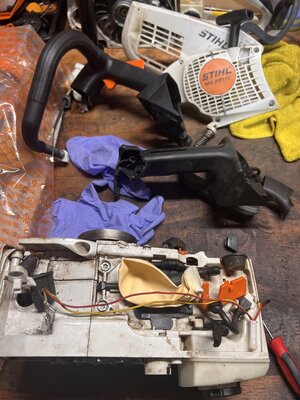

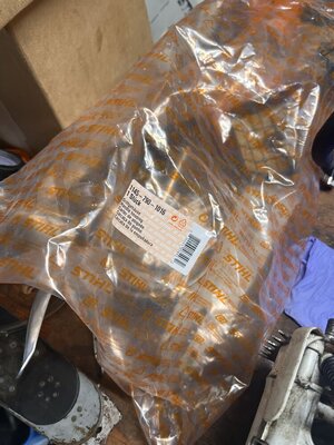

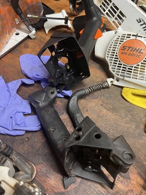

IMG_5767.jpegHandle problem, the one broken is 100% identically to the new one, but it has carburetor adjuster holes on the side for non mtronic, but this is an mtronic chainsaw. And that little square plug for stihl software came off this saw, but nowhere to plug it into the side, just carburetor adjustet holes on the right side. I’m confused. What did I miss?????

The handle 1145 790 1016 is for the MS 201 T without m-tronic. So you have the wrong handle. If your saw is built before May 2018 you need handle 1145 790 1008, after May 2018 you need handle 1145 790 1024.

You’re the man! It’s just weird to me because that’s the handle they had on it, and they’re is to many ways it won’t work, to even believe it did work before the accident.
