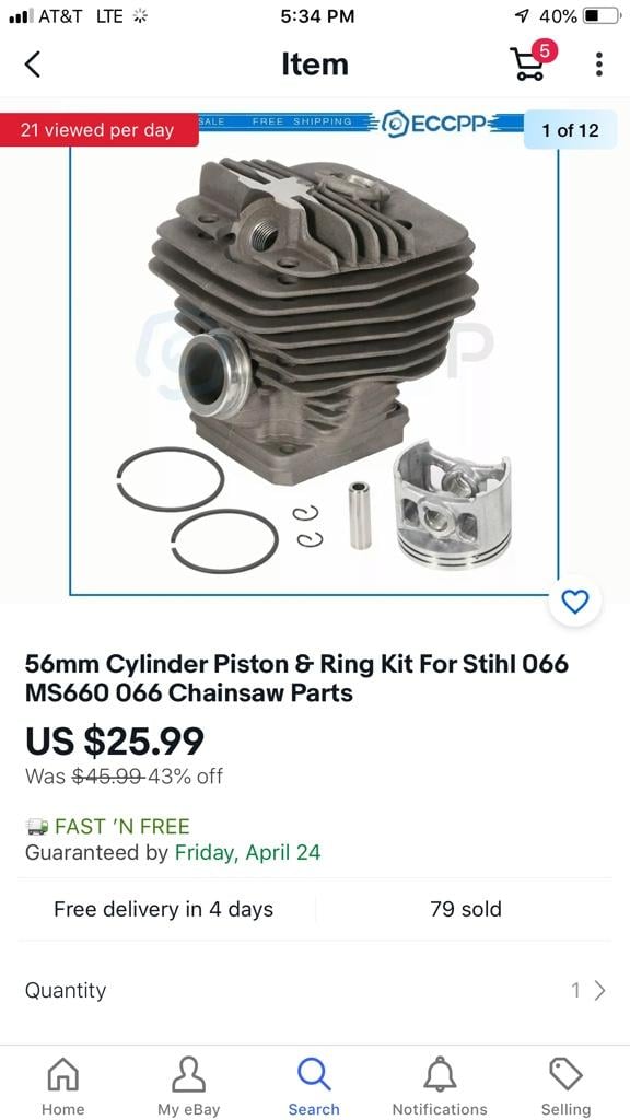

Obviously judging by the carbon on the piston, this saw has been running for a while. Things just don’t all of the sudden break.
The saw got hot and the ring gaps closed.
Or piston broke from heat.
Let me guess you all are the ones who ask around looking for a used oem cylinder.
