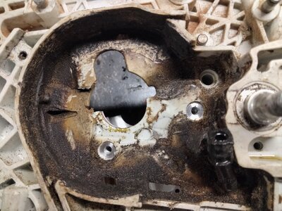

Here is what my 271 ended up looking like, that isn't bar and chain oil and crud, that is burnt plastic. I tried to shave out enough of the bad stuff to get the chainbrake to sit even and work correctly, but it didn't work, so I swapped everything to a new crankcase.
Thanks for the advice. Fortunately, my brake is still moving freely. There was a very small amount of plastic melted around around the edge. I haven’t found time to explore why the brake won’t release. Everything moves freely if I remove the brake around the clutch.
